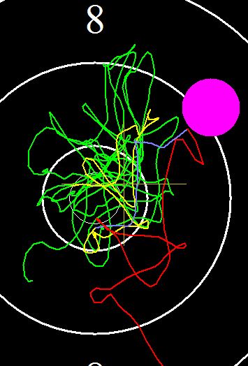

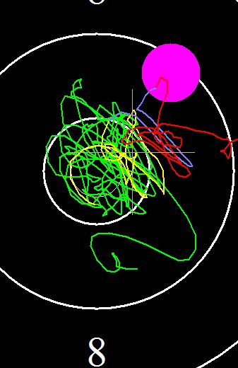

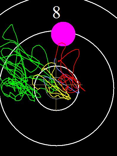

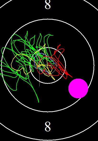

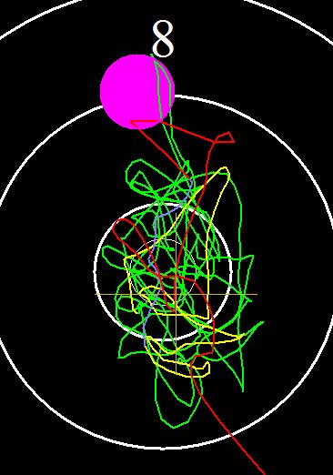

Yes I have it set to 40. Here are a range of samples (I can't find the one I popped off into the 8 ring - I might have deleted it in disgust.....)

Re: The last 1 second.....
For me that looks like you don't have you NPA in the middle. You see that the red line is very close to where the shot landed and that red line is where you are sighting after the shot and that is for me a indication that when your muscles relax then your muscle swings to a place near the where the shot landed. I find that on the SCATT the shot travels further away than if you did the same mistake in real life.
The gray line and the red line should be at the same point as your shot.
Hi David, it's difficult to be sure from static traces but I'd suggest there are a few areas for improvement here...
Firstly, are you holding too long? Probably yes. I'd suggest that it would be good to go from the entry point of the trace into the bull right through to the shot release in the 5 second window of your SCATT capture time.
Secondly, is there a trigger issue? This is more difficult to tell. I'd respectfully disagree that your hold is particularly good for a prone shooter - it's about what I would expect from a Club standard shooter. On some of the traces there seems to be a rhythmic movement which would indicate pulse transmission. On others the hold just seems a little "loose" which may be due to insufficient relaxation, using muscle to steer the rifle onto the target or just a generally unstable position - or even using a very small foresight element and hunting for the right sight picture.
Shots that jump out of the hold pattern like you are seeing happen because the barrel is moving quickly across the target at the moment of release - like shooting ON the pulse rather than between them. I'd guess that you're getting "L" values of 70 to 90mm which could definitely be improved upon with a little trial and error...
So what to do about it?
My suggestion would be
1) doing some Progressive Muscular Relaxation exercises to make you more aware of the inner tensions in your position with a view to minimising them. Relaxation is key.
2) Playing around with the point that the sling locates on your left upper arm. I have found that getting that right can dramatically cut down the disturbance caused by pulse which results in a smaller hold pattern and fewer shots out of the hold pattern. For me, higher is better. Low and medium sling positions produce pulse.
3) THEN look at your triggering.
Just my 2€...
Ken.
Just my 2€...
Ken.
