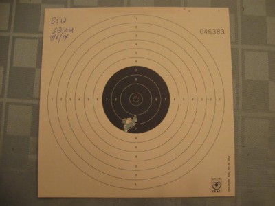

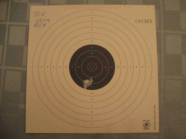

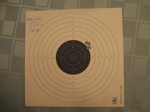

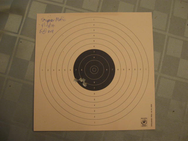

Here are some grouping from 3 different guns, hand held on a rest 5 shots each. all were shot at 6 o'clock on target. these all were .22 caliber. What do these indicate? Thanks Ron

You need to move the sights?

Distance for " three gun bullseye " is 50 yards slow fire, and 25 yard timed & rapid fire.
Your targets don't tell me much, except I think the second from the top seems to have the best grouping (no flyers). but that could be due to better technique , better gun, better ammo. It's hard to say.
I do think you will get better intel, by shooting at a longer distance though.
At least 25 yds., or even better, 50 yds.
The problem is that top notch target pistols with top notch ammo, are capable of shooting one inch groups at 50 yards (from a Ransom rest).
So, anytime you are NOT getting that kind of accuracy, it is pretty tough to tell you why from here.

Just shot a few off to see whats what. The top target was a High Standard Supermatic, second target High Standard "The Victor" and 3rd and 4 target S&W 41. Would like to try at 25 yards but don't have the space here. Thanks Ron

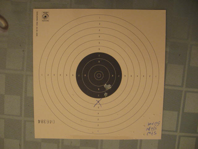

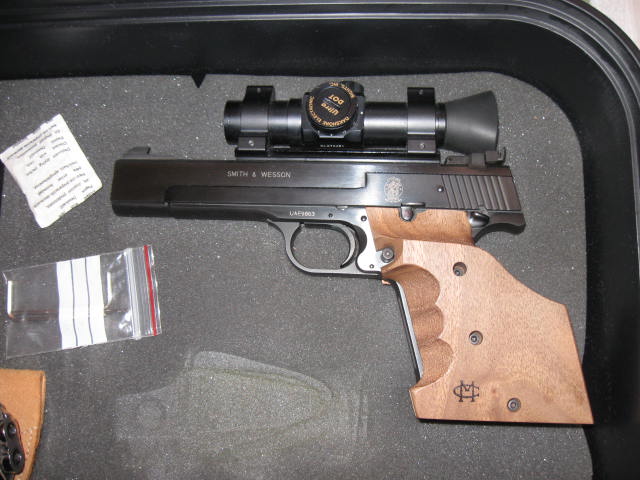

I have a S&W 41, among a few others, but it is interesting how targets 3 & 4 are so different. It almost looks like you had a different point of aim for each target. I would do them again. Once you get to the 25yd range, you should get a sub-1" groups at 25yds with the 41 and it will hold the X-ring at 50yds.

I think the third target is upside down. Still doesn't explain but better. Will try and spin to correct. Ron

darticus wrote:I think the third target is upside down. Still doesn't explain but better. Will try and spin to correct. Ron
lakesidemn wrote:I have a S&W 41, among a few others, but it is interesting how targets 3 & 4 are so different. It almost looks like you had a different point of aim for each target. I would do them again. Once you get to the 25yd range, you should get a sub-1" groups at 25yds with the 41 and it will hold the X-ring at 50yds.

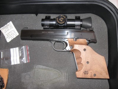

That makes sense, so at least the groups are in the right place. Nice looking 41. I have similar grips from Nill.
Your groups are tight, so it is just a matter of sight adjustment. When getting ready for bullseye though, remember to adjust your sights with free hand shooting and not from a bag. Group location off a bag will not be the same location as one-handed bullseye shooting. I watched a bullseye video from a HM shooter and he stressed free hand testing, which makes sense now that I tried it - "call the shot"!
Posts: 7079
As far as sight adjustment goes, I (and some of the better shooters I play with) will pull the stacked targets off the face at the end of a match so we can see the group placement of 90 shots. We then make any necessary adjustments and are ready for the next match.
This technique is much more fool-proof than trying to chase your shots during a match. Of course, if there is a gross error make an immediate change.
