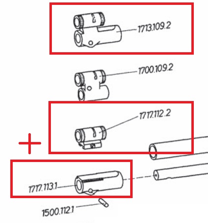

It looks to have a rivet holding it on instead of a screw. Is there any way to tighten? Thanks.
Hi,
as i remember right, there were three slightly different front sights on the FWB 300. The front sight base on all of them was clamped with a cotter key or a taper pin on the barrel. If there is no bigger sign of wear you can tighten the base with a pin punch.
Maybe the yet found picture can help you.
Regards from Germany
Frank
Frank
- korntunnels6lij.jpg (39.85 KiB) Viewed 1305 times
