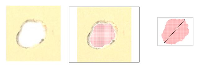

Actually, I made such scans of my air rifle targets myself as well recently. Only, instead of PSE, I used a Matlab programme to measure the 'hole' (internal surface only, in your terminology).
See an example below: left = original scan; middle = scan with identified hole filled; right is extracted hole with largest distance.
In this way, I can easily quantify the hole diameter, but also the hole area.
Or other measures that can be derieved automatically (and perhaps extress the shape of the overall hole?)

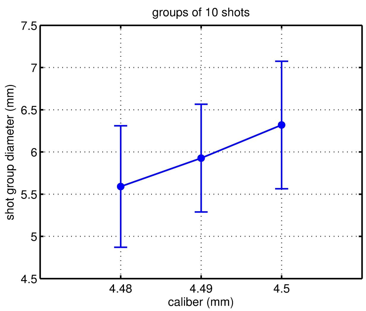

Why? Well, for example to look at effect of pellet caliber on the group size. I had 48 batches of RWS R10. Results: see the figure below. And yes, this effect was statistically significant. Telling me for the next time that I'd better start my search among the 4.48 pellets than among the 4.50 ones. So hopefully making my future testing more efficient.
Group diameter as a function of caliber (Mean and 95% Conficence Interval)

Well, you guys sure make my efforts look amateurish. Down the road, I'll remember your groups increasing with pellet size and see what I can do with it.
Great post! Thanks!

Rover, group sizes incerase with pellet size for my rifle. For other rifles it may be different.
