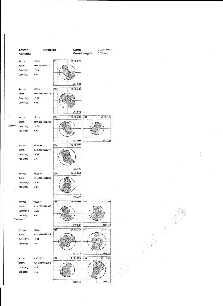

Results from Lapua:
Now I will admit there are a few things that make my test at Lapua unfair to the results; first there is no consecutive 40 shot groups, i feel this one of the more important features I received at eley. The method of testing is not the same, it seems to me there should be an industry standard. however i was responsible for the incomplete results. if i had take the time to shoot larger goups i would of been happier, rather I only shot till I saw that the group was going to be larger then I would want. The rifle was also not cleaned before the lots of eley were tested, this would change the eley results. As seen above.
Another disadvantage I gave my Lapua results is that I did not test anything higher then Center X, yet if you are on a budget this could be helpfull to find better lots of SK. When I go back I will test the better ammunition like Midas Plus or Xact.
For the record:
From my experience both locations have superb service I am not saying one is better than the other, I only wish to share so that other shooters will share there results.

Just picking this thread back up again. Cam, on the Lapua test, I gather what the 'Dmax' value is, but what does DHH stand for? And you mention that you had not tested the ammo as extensively as the Tenex. Would the guys at Lapua allow you to shoot 40 shot groups?
I need to get my hands on some match ammo and I'll be preparing to do what you did.

adrianS wrote:Just picking this thread back up again. Cam, on the Lapua test, I gather what the 'Dmax' value is, but what does DHH stand for? And you mention that you had not tested the ammo as extensively as the Tenex. Would the guys at Lapua allow you to shoot 40 shot groups?
Adrain,
I'm afraid I can not answer either question, you will have to call and speak with Darrell, when you find out about what DHh is please let me know.
IRLConor
Posts: 55
Joined: Fri May 03, 2013 10:48 am
Post by IRLConor »
Hmm, that DHH is interesting, it doesn't appear on my testing output:

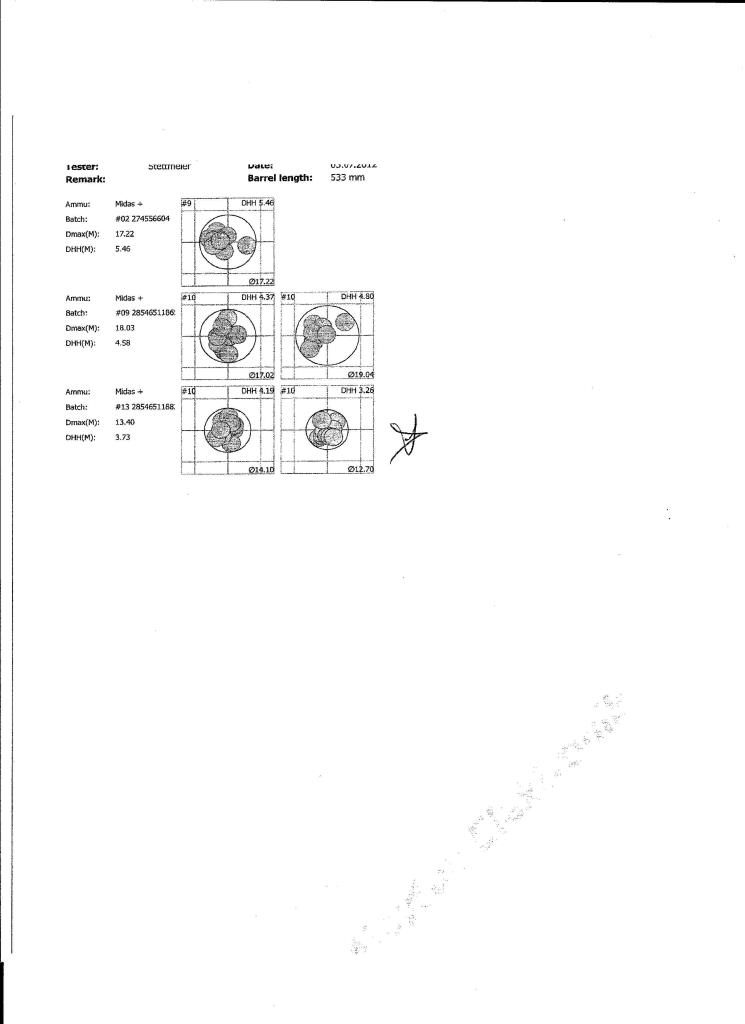

Here is another Lapua test, did not scan the 100 yd. Lapua also gives the group size at 100 which for most of us is not important, but to some it is. Darrel very easy to work with and they test with rifle in the stock. Tested some that after 5 shots could tell was no good and quit after 5.

cmj wrote:Here is another Lapua test, did not scan the 100 yd. Lapua also gives the group size at 100 which for most of us is not important, but to some it is. Darrel very easy to work with and they test with rifle in the stock. Tested some that after 5 shots could tell was no good and quit after 5.
CMJ,
What are the specs on your rifle? is it an Anschutz action with factory barrel? round or square action? I would like to know for the Excel spread sheet I am making. I am collecting as much data as possible.
