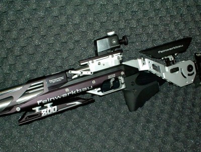

Hi all,
Since I live in Canada and air rifles are considered firearms if they shoot over 500 feet per second, all rifles brought in by Cibles Targets (the Canadian dealer for Feinwerkbau, Steyer, Walther) are de tuned to shoot at 495fps at the factory for the Canadian market. My question is, what impact would this make in competition? What is the standard velocity for these air rifles in the EU and the USA?
Cheers
