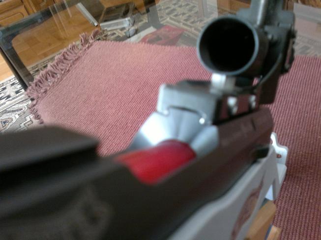

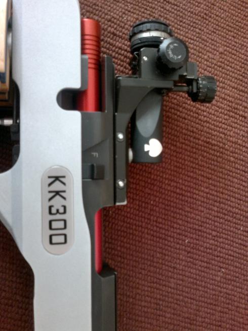

jkuna
Posts: 19
Joined: Sun Jan 29, 2012 6:22 am
Location: Croatia
Post by jkuna »
The Walther front sight dove tail isn't same as Anschutz but rear sigth rail is exact same as Anschutz.
walther 1.JPG (54.13 KiB) Viewed 11159 times
walther 2.JPG (47.73 KiB) Viewed 11159 times
jkuna
Posts: 19
Location: Croatia
Post by jkuna »
It's an Anschutz diopter on Walther kk 300.
