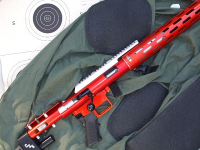

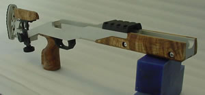

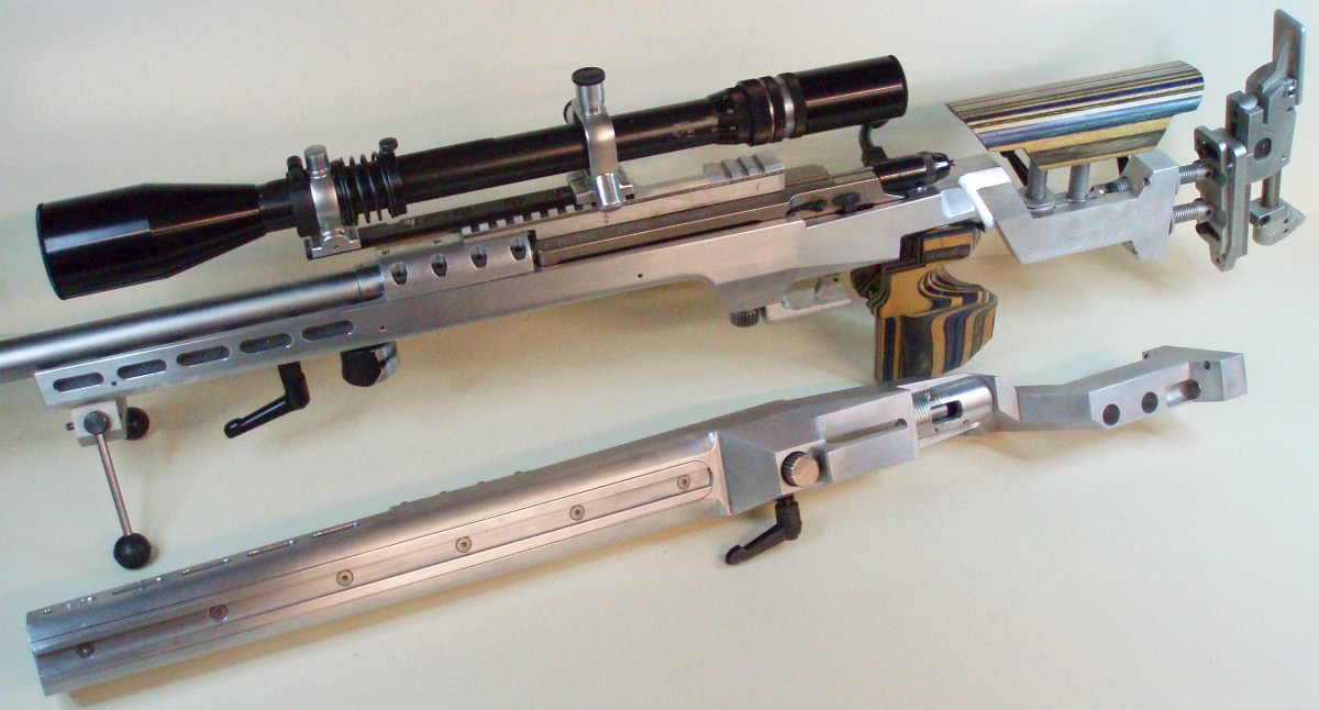

Im own an Anschutz 1813 super match rifle. It has the original 54 action barrel on it as well as the original stock. Ive been thinking of replacing the old wood stock for something with more adjustments like a sliding and cantable cheek piece as well as the ability to move the entire buttplate left or right. Ive seen models by Ross precision, Competition shooting stuff, intershot, and Jeff madison.
http://www.rossprecision.com/products_stock.htm
http://www.accurateshooter.com/stocks/r ... -in-tuner/
(Jeff Madison stock)
http://www.competitionshootingstuff.com/id14.html
http://www.intershoot.co.uk/acatalog/Rifle_Stocks.html
(System Gemini)
The stock needs to follow all NRA, NRA International, USA, and ISSF rules. It also needs to have 3-p capabilities. Any other suggestions or recommendations? Please feel free to ask me any questions or put a different stock out there.
Intershoot model : System Gemini
Competition shooting stuff model : AN-1
Jeff Madison stock
Jeff Madison stock
Ross Precision Stock

Voted Gemini. With Ross as second place. Didnt like the AN. Looks more militairy with colour than target..

Well my 1813 is in a Gemini stock so that gets my vote. But that's because it fits me very well and adjusts pretty exactly as I want it to. I would have preferred the Walter anatomic but it just proved impossible to buy.

Madison hands down, the best.

for me, Jeff Madison's stock is the most interesting due to the inbuilt tuner. Endless scope for fiddling...

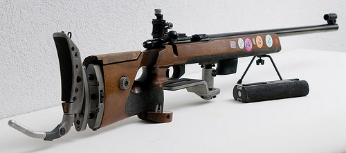

BAtarget
This is not my rifle. I own this type of stock with the original 1813 supermatch action and barrel
BAtarget
Posts: 51
Joined: Wed Oct 12, 2011 3:19 pm
Post by BAtarget »
the buttplate in the above photo is the same as mine.

I have Jeff Madison's stock. It is excellent. There is no comparison between his craftsmanship vs the cast aluminum of the German stocks. When you look at them side-by-side, it is stunning. He is a real pro.
