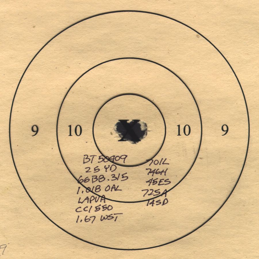

25 YARD Test Results - Cast Bullet
Post by fc60 »
Attached is a scan of a target fired at 25 Yards. Barrel is from a Haemmerli SP-20 mounted in a rest. The bullets are cast by me.
The barrel groove diameter measures 0.3135"
The bullet is the Hensley and Gibbs #66BB ~ 98 grains.
Some of my best groups have been with cast bullets. Sadly, I have not found the proper combination of Lead hardness and bullet grease to prevent Lead fouling in the barrel throat.
Dave Wilson
Test Target at 25 Yards
Posts: 7079
A delight to the eye!

fc60 wrote:Some of my best groups have been with cast bullets. Sadly, I have not found the proper combination of Lead hardness and bullet grease to prevent Lead fouling in the barrel throat.
Dave Wilson
Dave,
Thanks very much for the info.
I used a 1911 .45 ACP for many years (with hard cast SWC bullets) and never had to fight the leading issue. Have you been able to determine whether the configuration of the throat is different in a typical .45 ACP barrel as compared to a typical European .32 barrel?
It would seem that there ought to be some sort of explanation for this problem. If so, maybe that will lead to a solution.
