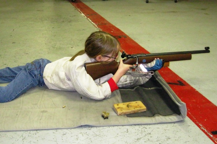

1941 Winchester mod 75
She has been using the clubs cut down 1941 Winchester mod 75 for the past few months with great success. She is almost out of prone to sitting. We have more Micro tiny shooters than guns.
We have our own range at home so it makes sense to own our own.

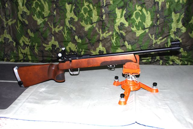

I should receive her new rifle today! Here is what we put together; We started with a CZ 452 Scout. The stock was shortened to 10.5” LOP and Installed front and rear Lyman aperture sights as well as a Fore End Rail machined into the stock for Hand Stop and Swivel. I’m really excited to see it. I will upload photos from shooting tonight. (if it comes in!)
Travis: This sounds really good. We have a CZ 452 that we shoot for Silhouette and plinking. I put a Leupold scope on it for my son. Sorry you had to go through the expense of all that modification though. My son is shooting in 4H and 4 position NRA for qualification. He's 12 and is in his 3rd year of shooting. He has achieved his Expert now and is beginning his Distinguished Expert. It sounds like the same program you are doing. My daughter also did this for 7 years and earned her DE Rifle.
Here's what we used for rifles...
IZH CMP-2 Cadet. This is an inexpensive rifle ~$350 that comes with good adjustable target sights, cleaning gear, hand stop, sling, apertures, etc. We replaced the hand stop and sling from CSS but had to modify slightly to fit the rail.
This gun took both kids through Expert. When my daughter completed Expert she switched to an Anschutz Model 64 with a cut down stock. My 12 year old son still thinks the Ans is too big and so is continuing with the IZH. I expect he'll make DE with this gun which is a testament to the gun.
I think the CZ will work beatifully for you but that was a lot of modification and I imagine it was costly. Support those kids shooting!
