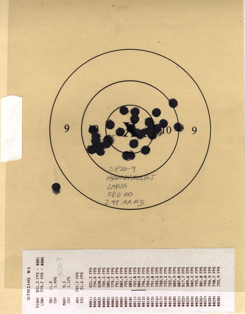

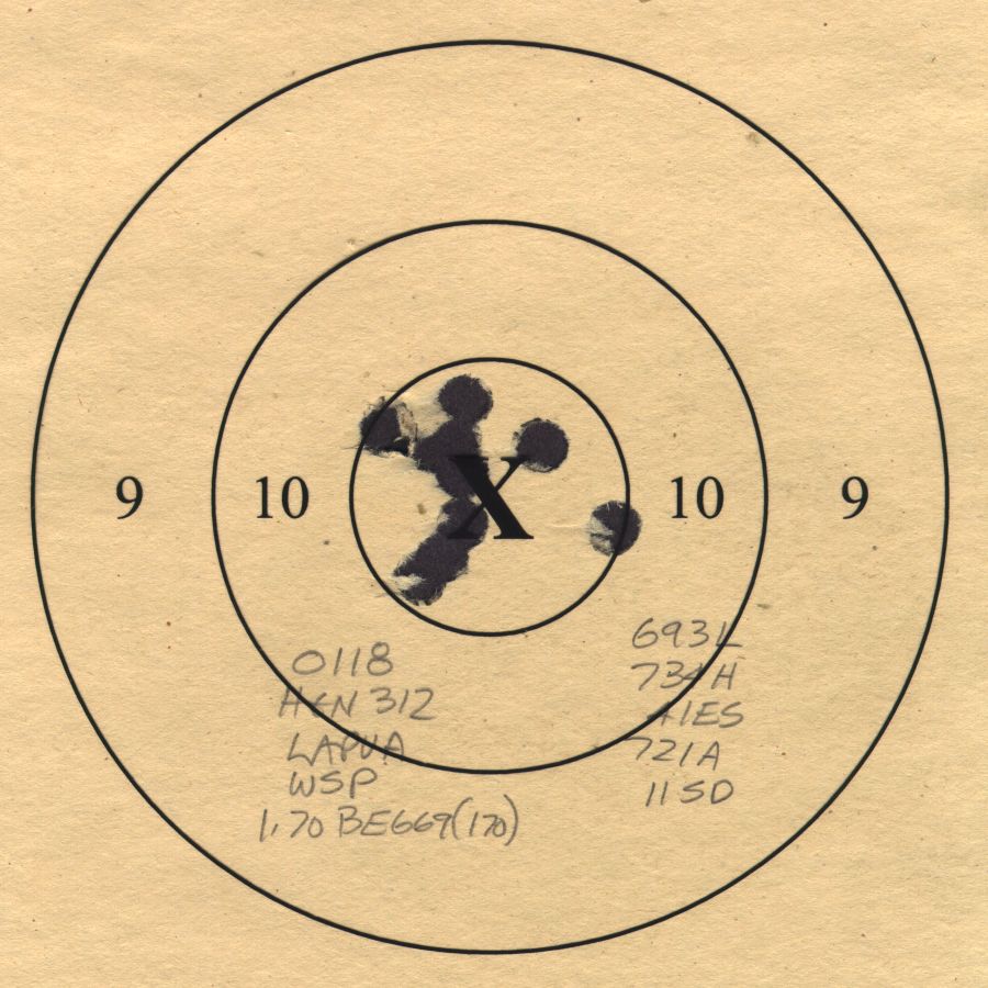

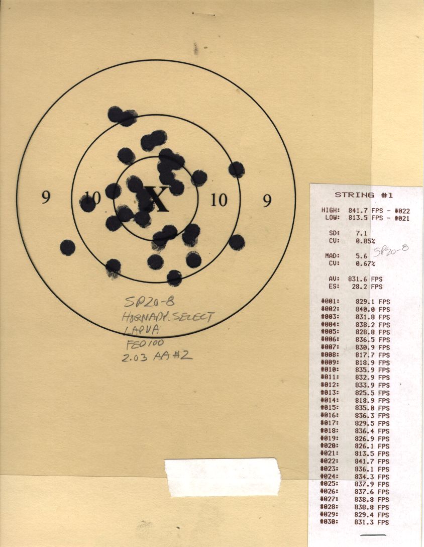

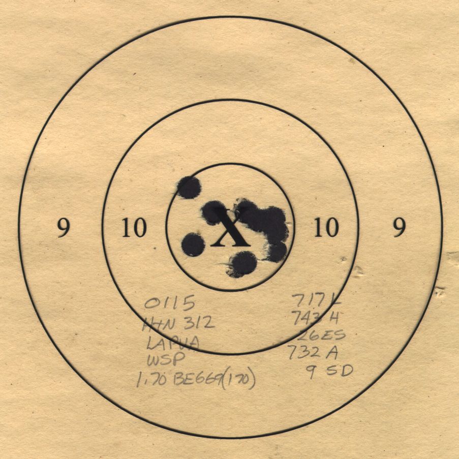

I just finished up two Pardini HP barrels and mailed them off. Currently, I have material on hand and no major projects pending. So, this would be a good time to have me machine a new barrel for your Pardini, Walther, FAS, Hammerli, Benelli, etc.
Attached are sample targets fired from a machine fixture at 50 yards.

You say "Fast Twist". How fast????

These two barrels were machined from a Shilen Stainless Steel 0.308", six groove, twelve twist blank.
Typical twist rate of the European pistols is 1:450mm (17.7"). This rate of twist works excellent for 25 meter shooting. For USA NRA bullseye shooting, a faster twist barrel stabilizes the bullet better for 50 yard shooting.

Yes, I use different barrel materials. I have used Shilen, Douglas, Remington, Lothar-Walter, and SGW blanks in the past.
The blanks have been received with 4, 6, and 8 lands and grooves.
I have used twist rates of 8, 10, 12, and 14.
All barrels would shoot X-ring at 50 yards with carefully assembled hand loads.
My goal, is to find the combination that, providing the stars align correctly, puts all ten shots in one hole.
Hand loading is the key. One must experiment with the bullet, powder, brass, primer, etc. to get the best results. I learned this early on from conversations with the best 32 experimenter/shooter I ever met, Darius "Doc" Young.
