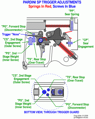

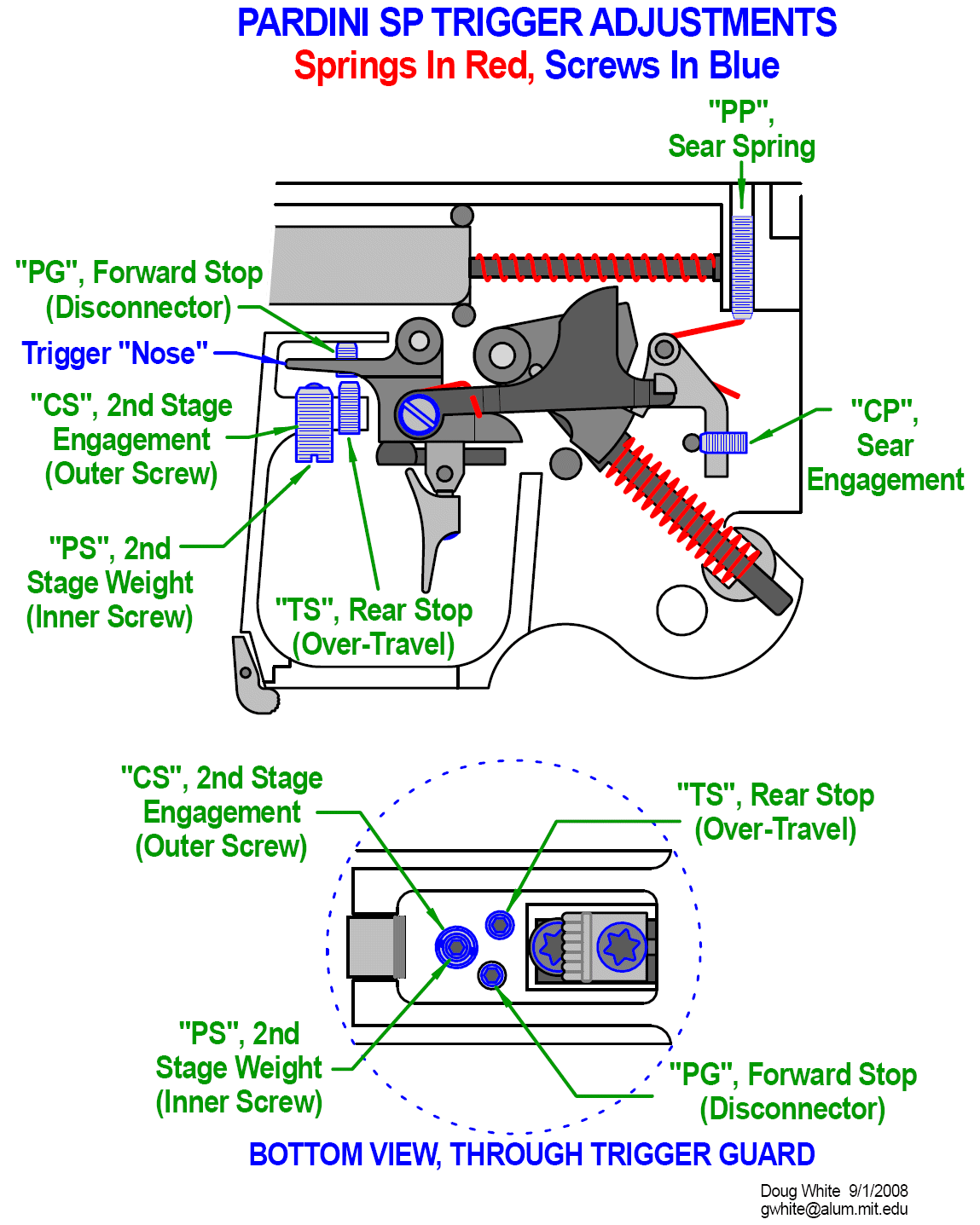

Every few months, somebody asks how to adjust the trigger on an SP. I was confronted with the same problem recently. The instructions in the book aren't very detailed or clear, and the diagram in the manual for the SP New looks like a Fax of a bad scan.
There is a good set of notes from Don Nygord that basically tells you how to set everything back to square one & adjust from there. However, it largely explains what to do, and not WHY. Being an engineer, I really wanted to understand the inner workings and what each screw does to what piece of the mechanism.

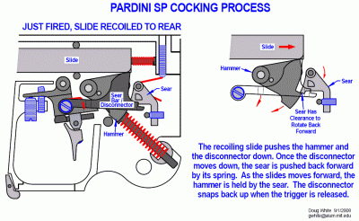

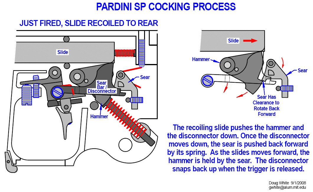

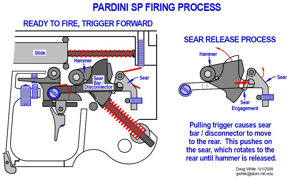

Step one was to create a better drawing. After that, I got carried away and made drawings of what was going on during the firing process, and the cocking process to show the action of the disconnector.
My plan is to put these all together into a PDF with some verbiage for others. In the meantime, I'd be interested in feedback on the drawings.
Here's the new version of what is in the manual:

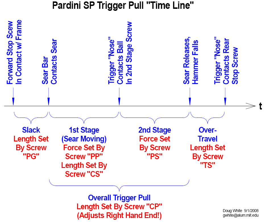

This last one is a "Time Line" of the firing process, showing the sequence of events, and which screw adjusts which part of the cycle.
The sequence is both more complex, and quite different from, what goes on in something like a High Standard. One of the things that threw me initially was that the sear is moving during the first stage, and that the slack can be adjusted out almost completely. In many older, simpler pistols, the slack IS the first stage, and can't easily be adjusted.
In order to shorten the overall trigger pull, you have to reduce the sear engagement, effectively removing the travel from the END of the process, not the beginning. When you make this adjustment, it interacts with other settings, most notably the disconnector / slack adjustment, and the point at which the 2nd stage kicks in.

Those diagrams are very helpful. I wish I had them when I had my SP and HP.
I have Don's instructions, but there have also been a couple of folks on TT who posted excellent instructions about how to adjust these triggers. Between their instructions and your diagrams, the factory might learn a lesson or two!

Absolutely fantastic set of diagrams. Like you, I've found the instructions in the manual verging on the incomprehensible..... These will be put to good use..
Nobody has found any serious booboos or typos so far. I've tried to make the drawings a bit more legible by fattening up the line widths in some places. Even with all the pictures, it's hard to describe all of the interactions.

I have a few problems with this diagram and setup time line.
The way I read your set up is you are using the sear screw "cp" incorrectly.
"In order to shorten the overall trigger pull, you have to reduce the sear engagement, effectively removing the travel from the END of the process, not the beginning. When you make this adjustment, it interacts with other settings, most notably the disconnector / slack adjustment, and the point at which the 2nd stage kicks in."
If you do this you risk a drop off of the sear and a machine gun discharge or typical a failure to reset on cycling because of not enough sear engagement.
The sear on the Pardini is a live sear, after engagement with the disconnector it moves though both First and Second Stage until discharge.
You have completely missed the setup and function of screw "CS" and its inner spring, ball and screw "PS".
After setting the correct sear engagement (this will set total trigger travel with full sear engagement), you need to set the sear release point.
Turn the screw "PS" full in until it bottoms the spring and ball (about 3 turns). Do not over tighten.
Turn the outer screw "CS" in a couple of turns.
Cock the pistol and with finger weight on the trigger it should be sitting on the ball in screw "CS" '
Very slowly turn the outer screw "CS" out until the sear disengages and the hammer drops.
You have now found the sear break point (and ball contact point).
For a break like glass trigger (short 2nd travel) turn the outer "CS" in 1/4 to 1/3 turn. (Do not go less than 1/8 turn)
For a longer 2nd stage travel (roll off style trigger) turn "CS" in up to 1 turn.
Now back off the 2nd stage weight screw "PS" to allow the ball to move with spring weight.
The second stage travel is the amount of allowable ball depression inside "CS" prior to sear break.
Set up your weight ratio between fisrt and second stage depending on how you set up the second stage travel.
Lighter first stage weight with "PP" with heavier 2nd stage "PS" for break like glass trigger.
For a rolloff trigger with a longer 2nd stage travel, you can use a lighter 2nd stage weight.
DO NOT USE THE SEAR ENGAGEMENT FOR SETTING SECOND STAGE TRAVEL.
Use the "PG" screw to set the disengage bar clearance to allow trigger reset (some small rattle is required).
Finally set the overtravel stop"TS", do not set too close, allow some movement.

Thank you for the additional notes. I had always meant to go back and add some more detailed verbiage on the adjustment process, but never got around to it. I certainly never meant to suggest that anyone reduce the sear travel anywhere near enough to to cause an unsafe condition. I'm not even sure there is enough adjustment to do that. I've never heard of anyone using these drawings having a problem getting a safe trigger with the trigger action they were looking for.

At the urging of a few new Pardini owners, I finally got around to cleaning up the notes to go with the diagrams...

Used the pictures when setting upp my SP a year and a half ago and now it's time to setup my new HP. Great work!
