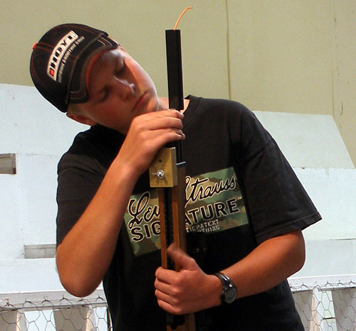

So here's my next question. Being that the T200 is light, I saw that there are barrel weights on the website for this rifle. Are those legal in competition?
S
jhmartin
Posts: 2620
Post by jhmartin »
Sure .... as long as you:
1) Don't exceed the sporter weight limit of 7.5 lbs (Rule 4.2.2)
2) Weight placement is within the rules (Rule 4.3.3)
See the 3P council rules on the CMP website if you don't have the book
NOTE:On Rule 4.2.3 ... if you hang weights on the fore-end (i.e. on the sling rail) the 50mm measurement is correct ... they missed a decimal place on the 20" .... it should be 2 inches.
Many of us grind down a carriage bold head to fit into the sling rail and then bolt lead weights onto it. Since sporter allows the sling adapter/handstop to remain on the rifle in standing, all the shooter needs to do is slide it all the way forward until it hits the weights and then tighten it down
Attached is a photo of an example .... note that we used this rifle as a 4-H silhouette rifle, so we had rail weights and a muzzle weight that took the rifles up to about 8.5 lbs I think.
