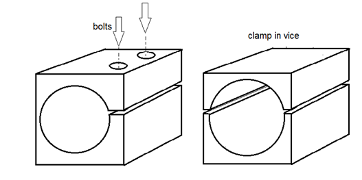

I later contacted a former dealer/repairer of the CP2 for his advice. He said I could share his tips, so they are posted below with his illustrations. I believe the device he used is called a split-block clamp. I don't know if it can be purchased in the correct size, or has to be made by a machinist. But, given the difficulty I had, it might be worth having one made, especially if you have many cylinders to work on.
"Being in the business I was required to do a lot of cylinder repair. I worked only on the CO2 cylinders, air was just starting to get popular, I did not work on the air cylinders. For the CO2 cylinders I had a machinist make up a steel clamp for me which worked very well. It looked something like this…It would be easier to make it simply in two halves and clamp it in a big vice.
Yes, It does take a lot of clamping pressure!! " - Ray McDougall

I use a wood block. I was fortunate enough to have a drill bit approximately the right size (although not exact), so I drilled a hole in a block of 2x4, then cut it in half, just like the image on the right. Because my drill bit was too small, I left the edges fairly thin, so it could spring out enough to fit the cylinder.
I did have trouble with it slipping in the blocks (possibly because my blocks were not exactly the right size), and I didn't have any inner tubes to cut up, so I lined the blocks with some strips of electrical tape. That provided enough grip on the cylinders I was working on, but it was borderline -- the tape got twisted around and had to be replaced after each cylinder, but it did the job.

I'd go with split aluminum blocks, but I've got machines ... back in CA anyway.
The wood block option could work as well, and you can get a good fit by 'glass bedding'. Shouldn't be hard to rough something out, even with a pocket knife if you're Jed Clampett. Wax a cylinder and bed it in with some Devcon plastic steel. Even the hardware store variety in a syringe will do the job. JB as well. DO NOT clamp right where the threads are. You can compress it to a pointt they'll bind, and aluminum galls (welds to itself) quite readily.
