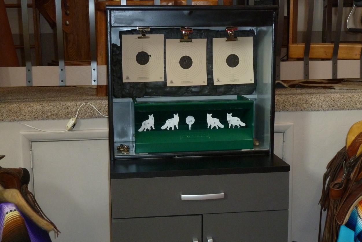

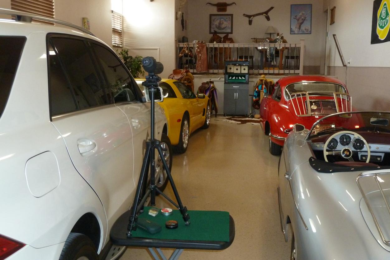

While I am at it I also want to ask if anyone has a unique indoor range/backstop for practise. I just built a new one in my big garage and shoot between the cars to acquire 10 meters (not so risky after all) It has 1 1/2" of ballistic putty in the back and led lights. The whole thing is fastened on a garage cabinette (with wheels) for a place to keep targets, pellets, original gun boxes. I am pretty proud of it but I am sure there are some real clever folks on this forum who can show me something I can do to improve it even more. Let's see your set up.

Wow. Want those cars. And garage.
I only shoot on a Gehmann pistol trap (spring loaded) from the kitchen to the living room.
