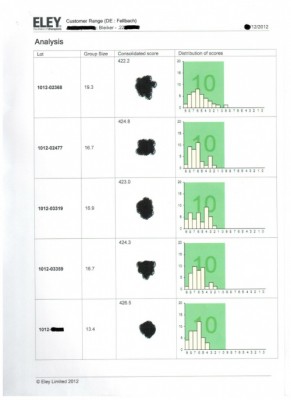

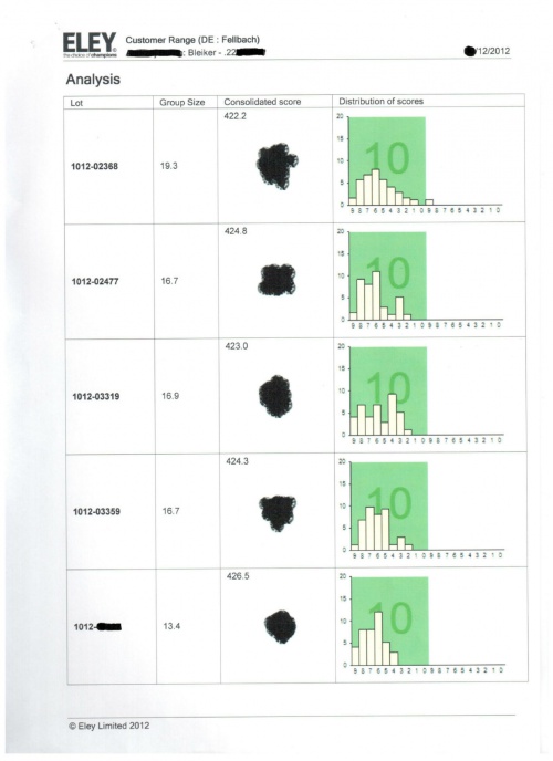

Here comes an test report from the Eley testing range in Germany and shows an at that time new testing record. The test shows a 40 shoots test with an 13,4 edge to edge group. But even this outstanding grouping will give only four 10.9. Most shoots will give an score between 10.8 and 10.6, but there are also five 10.5 and three 10.4.
But this is an really outstanding grouping. The other shown groups on that testing report are also good and show much more what an average owner can expect from his rifle and barrel. And there is more spread in the given result. There are 10,1 and even a 9.9.
We have also to know, the grouping of the ammo and our own grouping (our faults) will always statistically add and decrease our results. This is true for an world class shooter and it is also true for an average or club shooter, also it has not the same importance. The influence increases much more if your scores increase.
So i would say, ammo testing is always important. It can help you to increase your scores, will give you more sureness and confidence and shows you the quality of your own rifle and barrel combo.
Last note: I have seen an ammo test with my own eyes with an otherwise real good barrel which gave only an average score of 95 for 10 shoots on the ISSF 50m target. Even Martynov couldn't shoot more than 570 with such an combo. The used ammo lot was one of the highest match products. There was nothing wrong with that rifle and there was also nothing wrong with that ammo lot. It was only the wrong combination and it is sometimes possible that you also get such a combo if you do not test.
I'm only a longtime club shooter but i can tell nearly every time the difference of a 12 - 14 mm grouping lot and an 18 - 20 mm grouping lot when i test this lots out of my shoulder in a blind test. And my Anni and Diana barrels are not really picky about different ammo lots.

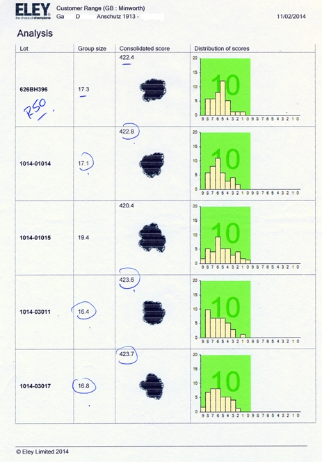

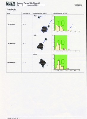

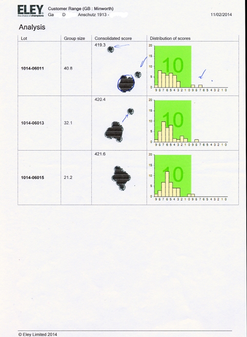

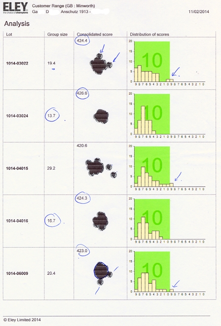

I would like to my comments about batch testing ammunition.
In February this year I went to the Eley factory in Birmingham in the UK and tested 24 different batches of Tenex.
To say I was surprised was an understatement, as the variations between the different batches was unbelievable, with the best 40 shot being 13.7mm and the worst 40.8.
Have a look at the print outs below and see what you all think.
The Group marked R50 was from a batch that I tested at Bisley in 2013 and was used as a reference to see if the Eley Ammunition could beat it.
