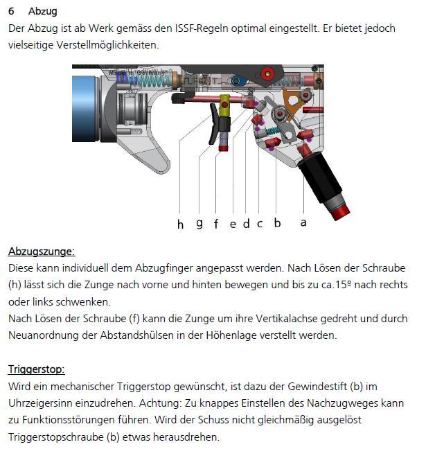

My main concern is as follow:
I have noted some irregular behaviour of trigger in shooting and not linear adjustment in trgger weight (is difficult to get 500 grms.)
I have noted some displacement of "Swivel Rocker" (part Nº 2774968 in exploded diagram) from betwen 0,5 to 1 mm. This part has no adjustment, but i think that this movement is responsable for the erratic behaviour of the trigger.
I have sent an e-mail to Walther but the answer was not satisfactory to me (came in German and is a part of Adjustment from the manual), no mention if the part Nº 20 must be move or no.
I would be very appreciated if someone have same concern and the solutions if is needed.

May I suggest another solution (I'm head of press & communication for the Walther-group and pistol shooter myself).
At first I must apologize, that you received an answer from the company in german (assuming, that you didn't write yourself in german...).
I've talked some minutes ago to Thomas Bretschneider, head of the design team of (among others) the LP400.
Here is a link to a more explicit exploded view, also with translations german/english of the parts:
http://www.carl-walther.de/public/downl ... _LP400.pdf
I would recommend in general for every foreign customer with questions to check at first the english(!) part of www.carl-walther.de - in the (somehow irritating) PRESS menu you will find manuals and also exploded views of all actual and a lot of older WALTHER guns:
http://www.carl-walther.de/cw.php?lang=en&content=press
These described variations of the trigger weight were often mentioned by LP300-owners, with the LP400's new trigger design it should be better - in most cases...
Tom Bretschneider by the way doesn't believe, that a slighly moving swivel rocker (0,5-1 mm measured at which point??) influences the continuity of the trigger weight. But you never know...
Two possible explanations for that complaint:
1. The second stage trigger weight may be too low in comparison to the first stage trigger weight. Your problem could vanish, if you (slightly) increase the second stage weight. That's the easiest way for repairs "in the jungle", without a certified Walther dealer to get help from. If you don't want to alter the relationship betwen first and second stage trigger weight (I can imagine some reasons), we have to use a bigger caliber...
2. (more complicated). If you can e-mail your address to me: press@carl-walther.de , we would send you a new spring, that has been introduced to newer LP400 models since last month. For all the other obviously curious readers the way to go on:
To allow a lower second stage trigger weight the spring no. 148 (part no. 2744298) has to be replaced with the new spring no. 2802261 (not mentioned in the diagram). Additionally the Slide catch lever spring No. 191 has to be.... (drums....)
removed completely, it's not needed anymore (if the spring was replaced!)
We would recommend this operation to be done by a certified Walther service man (or woman), but perhaps we can try it "remote", if you send us your address to send you the new spring (of course for free!)

Put a small drop of lube on the sear notch. I had a similar problem with mine. The trigger weight went up to over 700 grams within the first 2000-3000 rounds and I couldn't adjust it below 600 grams. It has over 10000 rounds on it now and it's still holding at the 525 grams I set it at after lubing it.

I have just received the new spring 2802261 and removed the other springs. Excellent feel to the trigger now, and adjustability greatly improved. My only question is that Screw C sticks out approximately 1.5mm from the frame - is this intended? I didn't measure the spring length before I swapped them out.

I just got my new LP400 (cilynder date 10/2014, so I assume the gun is from the same date). I assume it comes with the "latest setup " springs!
Adjusting the trigger was a pain in the ass! The second stage was so heavy, so I removed the 2nd stage spring to check if it was the cause of the problem!
So I found out that the poroblem is the sear engagement! go get a lighter second stage, instead of the normal 1/4 to 1/2 anti-clockwise turn (like the procedure described on LP300 manuals and other APs), I had to adjust it for 1/12 of a turn ( yes, just a turn 30º )! I taped on the gun, on various positions to ensure the trigger was firing without pressing it!
The second stage screw is unscreed all the way, so I used a bit of locktite to to ensure it doesn't come out... I can always cut a bit of the spring!
Now, the trigger feels good for me! Very crisp, but also with light second stage!
My conslusion is that, regardless the springs (that you can adjust), the sear angle was conceived for a very crisp trigger! I guess with time it will polish a little and I will have to re-adjust it!
The factory trigger setting are ridiculous, very long and light 1st stage, a a brick wall on 2nd stage. No wonder why people complain so much ... (most of the shooter I now are afraid of deep tweaking their guns)!

If you do a search you will find the trigger has been discussed a number of times.
The second stage was a balance between two springs (one adjustable). These opposing
springs set up a feel so that little or no trigger collapse was felt on sear release.
The problem with the original trigger was the inability to reduce the second stage weight
down to very low values.
Some coaches would say insane weights on second stage.
What happened was that the second stage spring was fairly stiff but with limited range, so
you reduced the spring contact to reduce weight and the spring would loose any contact
(ie no compression) this made the sear unreliable and total weight variable.
The update was to remove the paper clip spring and change the second stage spring.
This gave a lighter second stage weight but in my opinion it also changed the let off feel.
My solution was to keep the paper clip spring opposing the second stage spring to keep the feel
and to change the second stage spring to a lighter coil weight but with increased length.
This gave me a lighter second stage weight and increased the adjustment range to keep a
linear adjustment on the sear.
My trigger has a nice feel with a reliable 400/120g weight.

Mine is around 430+90!

Mine is also very crisp now. Second stage weight is finely adjustable with whole turns of the screw I made from acetal, coupled with very light but long spring. Pictures aren't very clear but show what I've done. Also is a picture of rear sight elevation adjustment knob.
