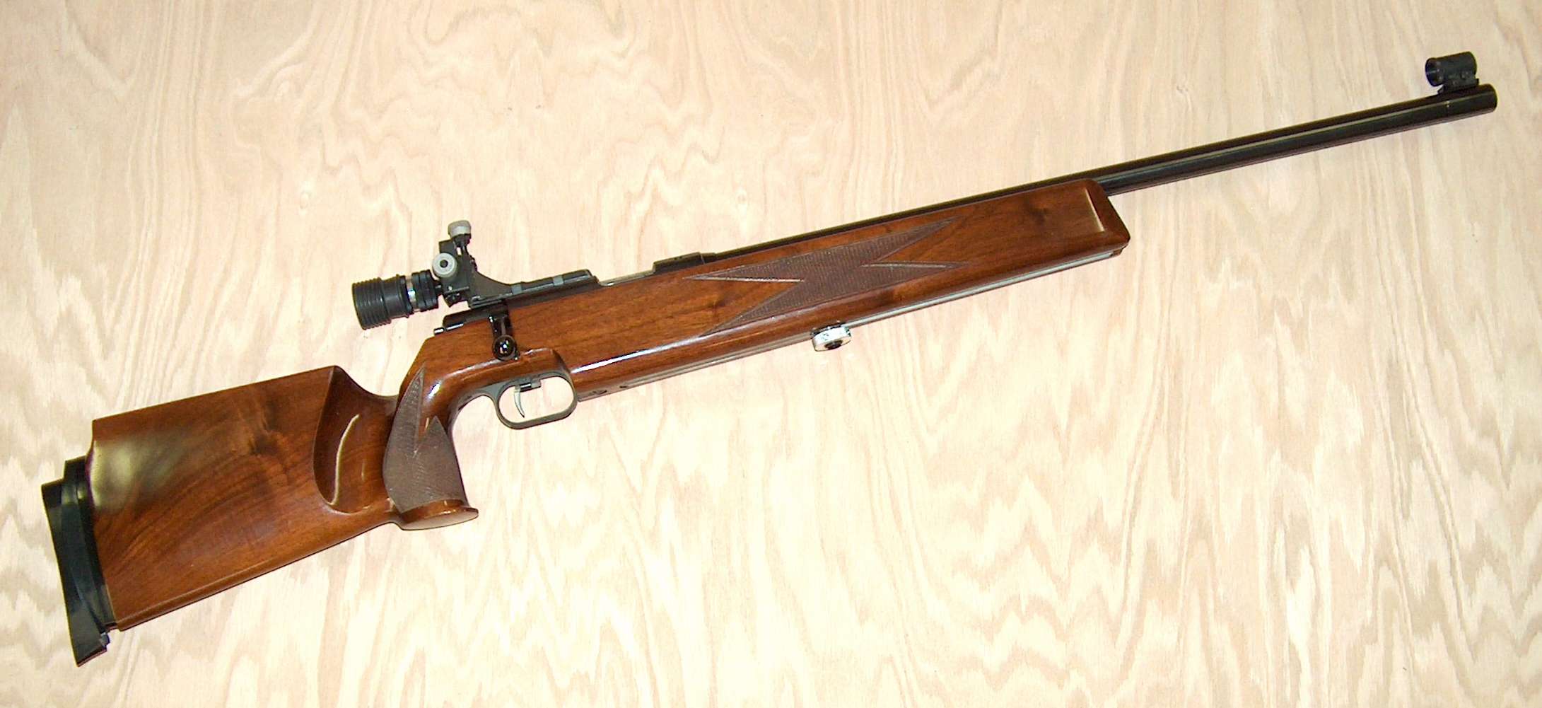

It would be nice to have pictures of the different stocks to identify the models. What exact model is this one. Barrel dated 1969 match 54.
Posts: 2093
It's an Anschutz 1408 or 1407 ISU standard. The rifle was introduced as the 1408 in 1965, but around 1969/70 Anschutz changed it to 1407. The change in model number was not accompanied by any significant change to the rifle that I can tell, just that the chequering was replaced with stippling.

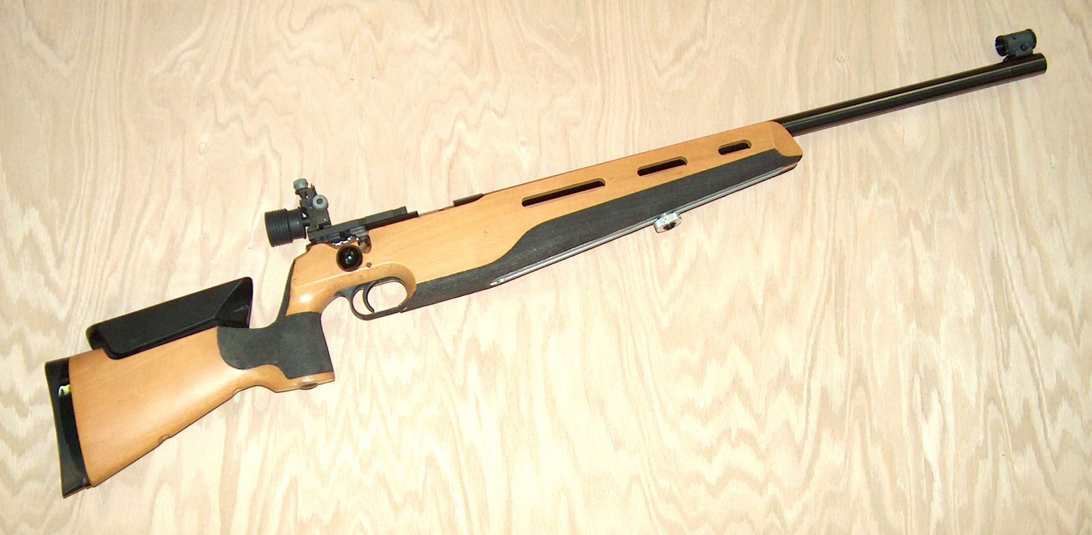

Thanks for that information, what about this "pre" or early 1803 model 64?
Posts: 2093
It's an 1803, not much else to say. Plain beech stock patterned on the 1807, steel 6702 rearsight, and a sinmgle stage trigger. Made in the 1980s.
