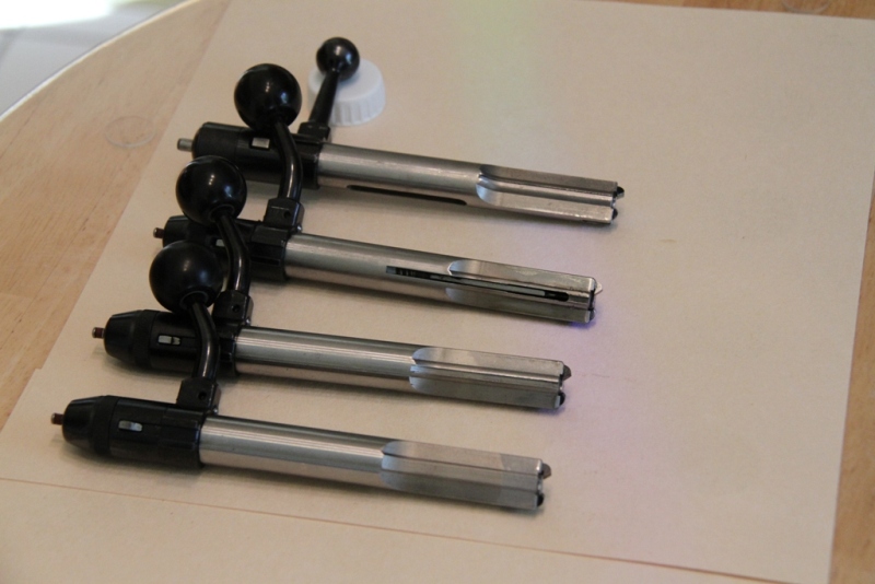

I just went to look, there appear to be three variants of the "cone back" bolt. You are correct, the 16xx bolt is slotted underneath the main body of the bolt so you can see the bottom of the firing pin. The 18xx and 19xx bolts are all closed with two variations. On the early 18xx bolt there is a groove on the bottom of the bolt that goes over/around the ejector pin. (Just on the forward part of the bolt body that is over the loading tray) Late in the 18xx the bottom of the bolt is milled down so the groove is gone.
Yeah, 78-80/81 was about the run of the X serial numbers and it was right in this period Anschutz was working a bit with release lever geometries so I would not be surprised to see a late X series with the true 18xx bolt and trigger. On casual observation the differences between the 16xx and 18xx trigger (507? vs 5018 I think) were subtle so you need to pay attention there as well.
The bottom line to all of this discussion, a person needs be careful that the bolt and trigger were meant to go together.
So others can see what the heck we are talking about I am putting up a picture of 4 bolts, a 14xx, 16xx, early 18xx and late 18xx/19xx. From top to bottom, note the bottom of the 14xx is closed, the 16xx is slotted, the early 18xx is closed with a groove where the slot on the 16xx is and the late 18xx/19xx has no groove, just a slight raised area. Not the greatest picture but I think it gets the idea across.
The bottom line, you should be careful the bolt and trigger were meant for each other.
4 bolts (top to bottom) 14xx, 16xx, 18xx and late 18xx or 19xx.

spot on! As far as I can tell/am aware all 18 and 19 bolts are interchangeable (allowing for headsapce). I presume the change from the groove to the flat on the front was just to save machining time and reduce costs.
All the 1980 16/18 hybrids I've seen had the 5018 trigger, no difference to any other. Mine 1980 non-slotted bolt and 1979 slotted bolt can't be swapped. For reference even the smaller springs at the back of the bolts are different, the 1613 is slightly shorter. I managed to swap these by accident last year - the result was a near 90% misfire rate.
