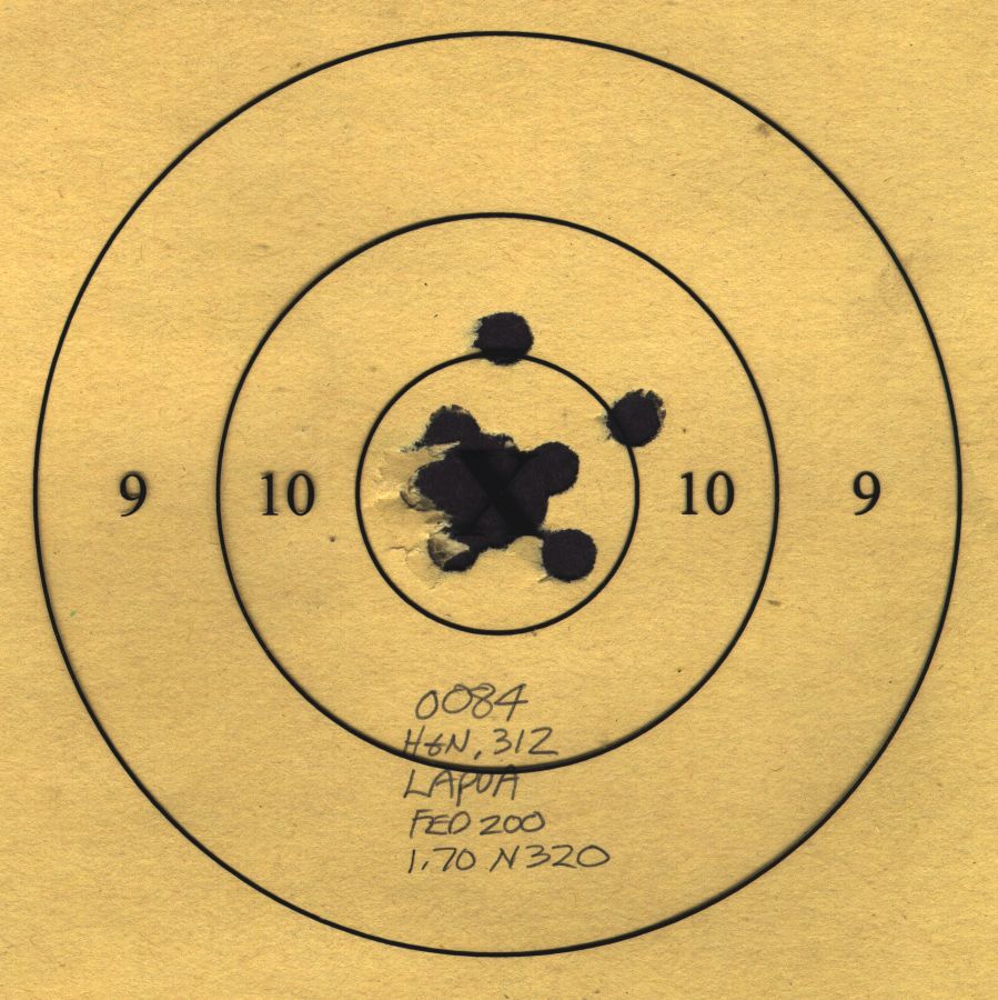

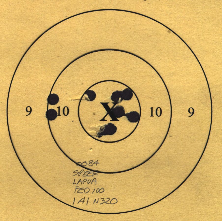

I test my barrels with 1.70 grains of VV N320 (three-twenty) with both Speer and H&N HBWC bullets. Expect velocity to be in the range of 725FPS.
Pardini HP with Wilson Custom fast twist  barrel. Fired at 50 yards. Ten shots.

Thanks for the recommend re N320.. I have a bunch of it and have just acquired a new pardini .32 to go along with my .22. In process of getting bullets and brass. Will be using both Hertinberger and lapua. Is that 1.7 grains of N320 at 725 fps considered a slightly hot target load compared to say 1.5-1.6 of either W231 or bullseye. Also for anyones info the small powder bar on my 550 dillon will throw N320 down to 1.5 grains consistantly. I thought I might have to get the exrra small bar but appears not.

I us N320 for my HP loads---I use fed primers, 1.2 gr. N320 and 100g DEWC and Rem brass. I had to get the mini bar for the 550B and a micrometer adjustment screw as well, in order to get consistency. You are correct in trying a commercial load and then match the velocities. I personally think that 1.5 gr will beat the stuffings out of the HP eventually. "Doc"
