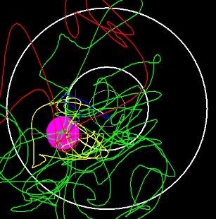

Here is a typical example of long vs short on a Scatt.
Scatt 1999.jpg (53.56 KiB) Viewed 4214 times
Long barrel with 2 barrel weights, longer, slower wobble trace but forgiving to triggered shots due mass dampening.
Scatt 2009.jpg (38.09 KiB) Viewed 4214 times
Short barrel with no barrel weight, unforgiving to poor triggering (will easy pull poor shot to 7-8 ring).
Much faster but tighter wobble.
Yes there is 10 years difference but scores still around 575-580, highest scores were shot with the short barrel.
The traces really show the difference.
