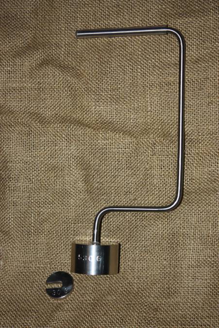

I thought about making a trigger weight set, but as I considered the weights I'd have to make and what increments would be useful, I realized I don't need a general purpose set. For just an air pistol all I really need is Go-NoGo gauge, so I cobbled this up in the shop today.
The weight is JB Welded to the hook (hey, at least there's no duct tape) and the assembly weighs 530g. The additional weight is 30g. If the trigger lifts one, but not both, then the trigger pull is between 530g and 560g. How it is distributed between first and second stage is by feel anyway, so I don't need a weight for each stage. Simple and fool proof. Well, fool resistant anyway.
Roger
Roger

mca -
I can machine it down to within .01 gm or less - I run a machine shop in a research laboratory and have access to all kinds of precision scales.
The way in which the weight is set on the trigger and lifted can affect whether a trigger right on the mark passes or not. Also, springs get tired and can easily get out of spec if they aren't checked for a while so I decided to leave a 30 gm margin of insurance. Besides, my fingers are not subtle enough to detect the difference between 500 and 530 gm pull, although I can see how a shooter on a higher level might feel differently. YMMV, of course.
Roger
Roger
Hi Roger
30 grams does not make a difference in AP. Let me get this clear. But...
Since you already made an extra 30g weight there is no point in having the original weight at 530g. Those 500g +30g are quite sufficient to get you passed in even the most clumsy EQ officer.
60g equals a 12% increase on the minimal weight of the trigger.
If you might not feel the difference, but you are putting 12% more force to pull the trigger than you have to. This increases the tendency to slap or jerk the trigger, and also makes you grab the grip a bit harder. With training all of this can be iron out, but you're still starting a bit back than you have to.
Get it down to where it barely lifts the 530g and you will see that you can lift the 500g without much care.
Hope this helps
Hope this helps

I see where you are coming from, but my intention was to make a "go-no go" gauge. The lower weight just shows that the trigger has enough resistance to pass a test. The 30 g weight is then added to make sure that the trigger fails, guaranteeing that the trigger pull is more than 530 g and also less than 560 g. This is probably a result of my experience in manufacturing and quality control, albeit a bit obsessive/compulsive for this particular application.
I grant that you are right that this is an overly generous "go" range. A better idea might be to make the weights 520 g and 10 g. However, I made this right after I started shooting AP and it made sense to me at the time. BTW, soon afterwards I started shooting Bullseye and compared to the the minimum 2 to 3-1/2 pound (907 - 1587 g) pull on those guns, 530 g is very light.
Roger
Roger
