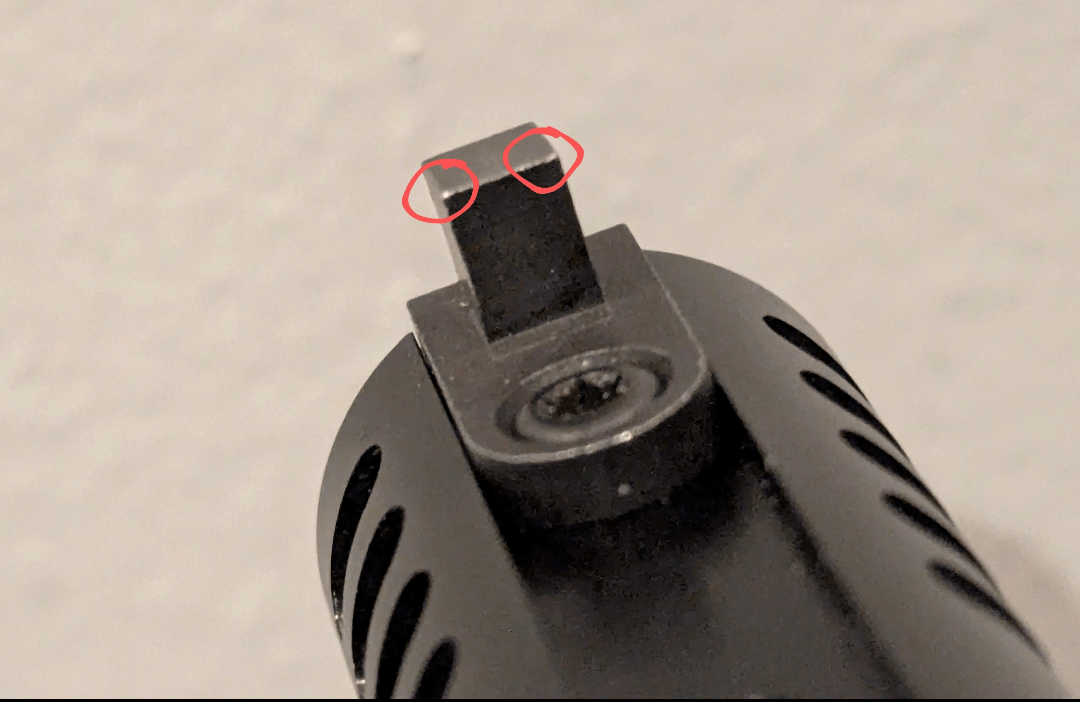

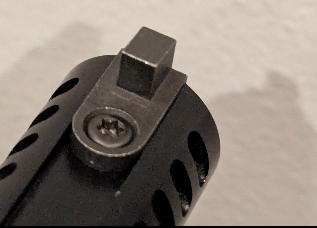

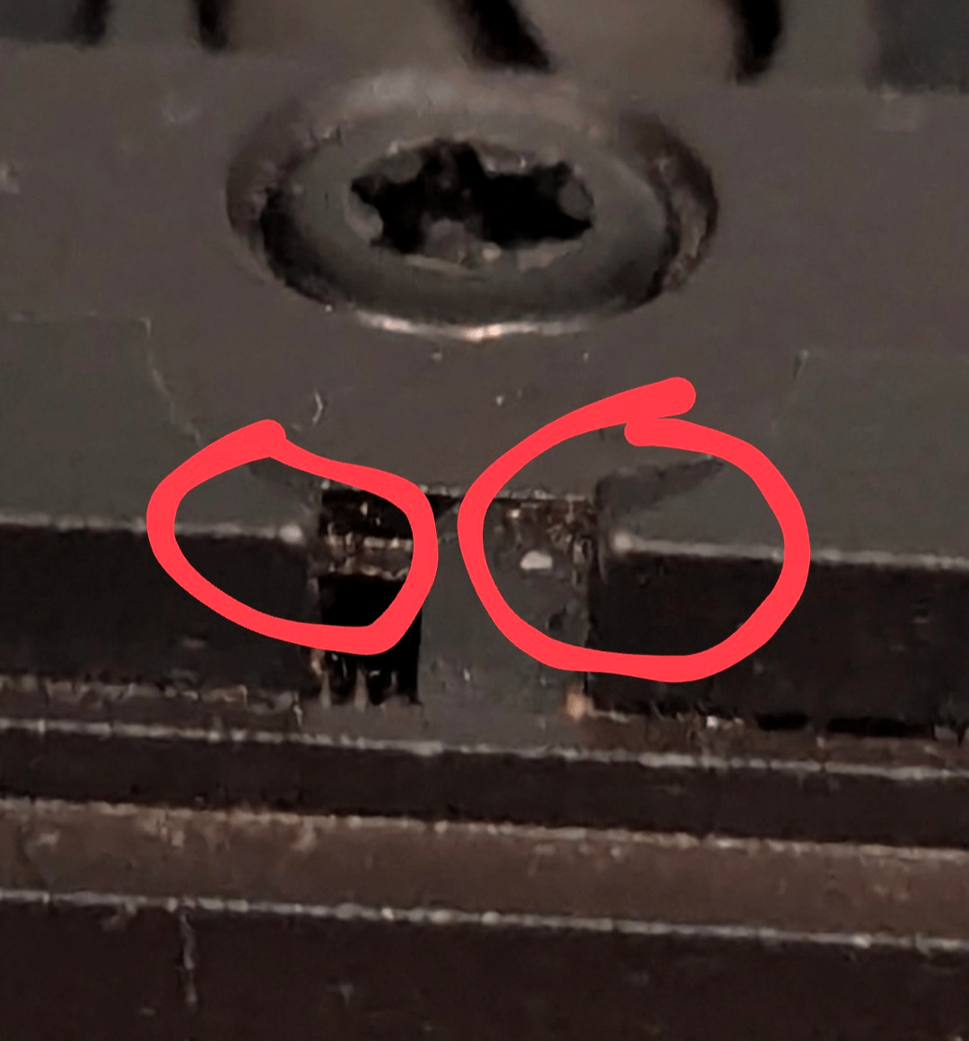

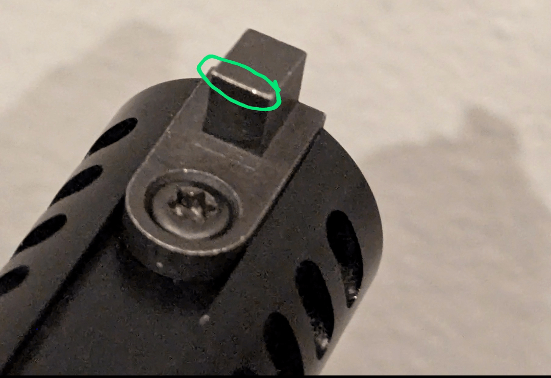

Hi,
I hope all is well. I am a brand new shooter (4ish months in) who recently got a used gun. The gun works great, but the sights are a little scuffed up.
Namely, when I try to line everything up, I can see a rough edge on the front sight (and rear sight to a lesser extent). I can see the discolorations and scratches. This is making it hard to get a perfect sight picture as I can't 100% tell when it's all aligned.
The variation in color (black where it's in good condition, but more silvery in other spots) also adds inconsistency.
Any thoughts on how to beat fix this?
Thanks!

There are a couple main choices:
* Stop focusing on them scratches and live with it,
* Blacken the sights with shoot or some kind of marker.
Actually, try both options :) Really focusing on the front sight will help them disappear.

Perma blue from birchwood casey.
It´s a cold blue solution that works very well.
Degrease the parts very well before applying it.
