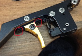

I am looking for the size of the set screws by the trigger blade on the Morini 162EI. See picture below. The front one is for the trigger take up. I am not sure what the back one is for if any one can inform me.
They don't seem to be listed in the exploded views or parts manuals that I have found for the Morini 162.
Any help will be appreciated!

Since it is not listed as an adjustment screw, I would not try and adjust it on my pistol.
Re: Morini 162 Screw Question
From memory the front screw either a 2.5mm x 0.45 or 3mm x 0.5 grub screw to adjust 1st stage trigger travel.
Maybe 3mm, I think.
The rear hole was originally for a trigger stop screw , but the electronic trigger does not have any trigger
collapse on release. So not required nor fitted as the loads do not change on firing.

That makes sense! Thank you!
