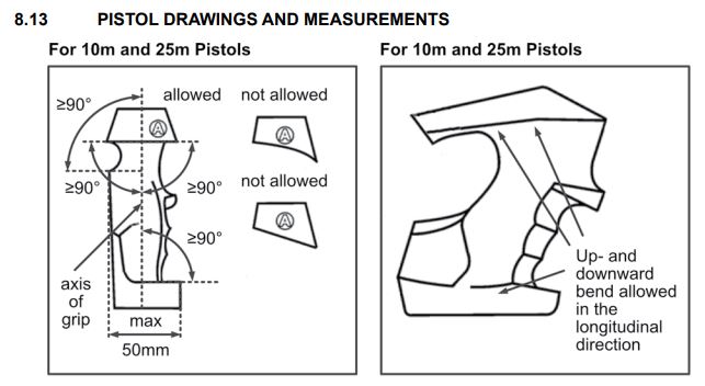

Third, read the rules before you start modifying it:
https://backoffice.issf-sports.org/getf ... ersion.pdf
8.12 ) 10m Air Pistol Grips: No part of the grip, frame or accessories may touch any part of the wrist. The heel rest must extend at an angle of not less
than 90 degrees to the grip. This applies to the heel rest in front and behind the grip as well as on the sides.
Any upward curvature of the heel and/or thumb rest and/or a downward curvature of the side opposite the thumb is prohibited. The thumb rest must
allow free upward movement of the thumb. The grip must not encircle the hand. Curved surfaces on the grips or frame, including the heel and/or
thumb rest, in the longitudinal direction of the pistol are permitted.

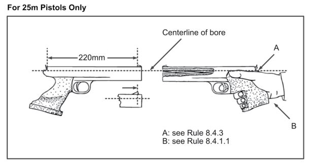

Although this image is for 25m pistol, it gives you an idea of what your aiming for in terms of griping a pistol.
Hope this helps
