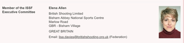

Your representative in England:
Dagpistol
Posts: 13
Joined: Sun Jan 01, 2023 7:45 am
Location: Surrey, England
Re: Air pistol training routine for an oldie?
Post by Dagpistol »
Thanks, that's a good point and I'll remember to check with her if I should decide to try supported pistol. For now though I will try and exercise the wrist and forearm to steady myself unsupported.
