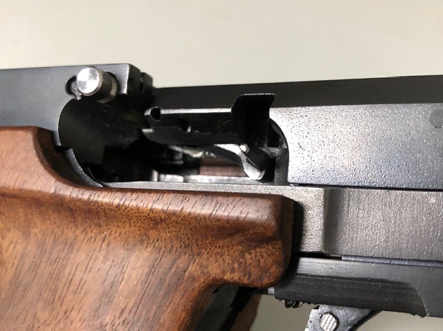

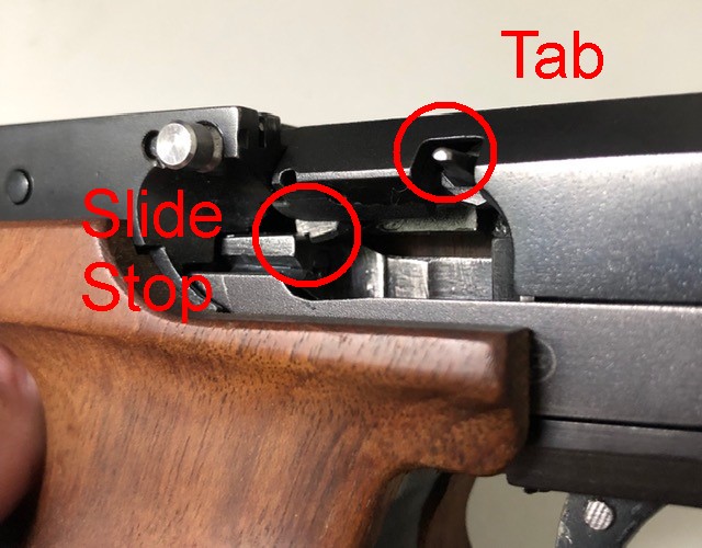

The tab is attached to a hinged, shaped bar which serves two functions: when the tab (actually a spike) is up it introduces a slide stop at the rear of the "bar" (first pic); when down (with the slide back) the shaped part at the front of the "bar" helps guide the next round into the chamber rather than allowing it to tilt up and hit the breech, as JamesH mentioned.

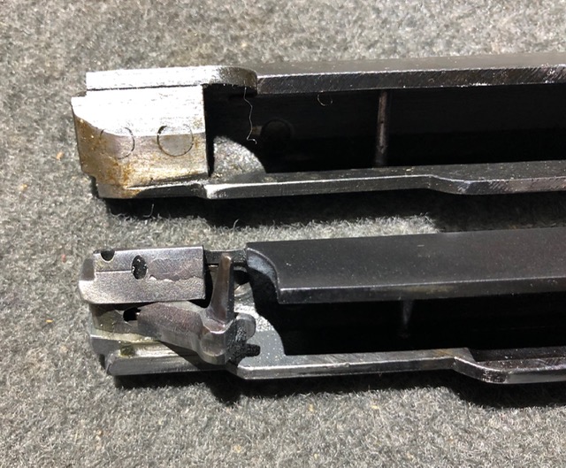

BobGee
Posts: 590
Re: IZh35M going full-auto..
Post by BobGee »
Better pic of the shaped bar/slide stop. Top IZH-35M, bottom MP-438.
