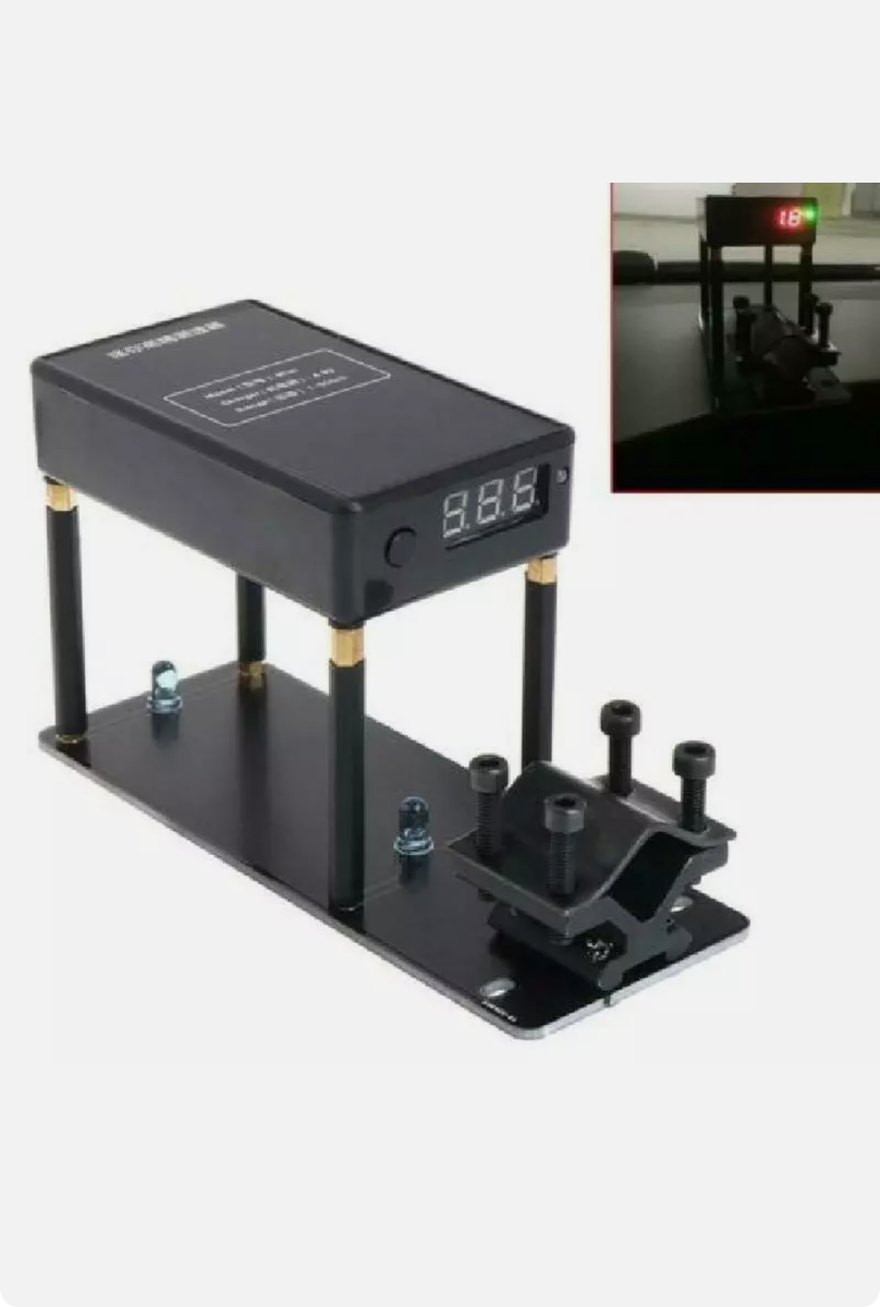

I have one of these. Never failed to read and gives the same results as units costing 10x more

Ade C wrote: Wed Jul 07, 2021 11:14 am Screenshot_2021-02-04-11-21-41.png
Can't read the name in the photo. What is it, where did you buy it, and what did it cost?
Dennis, aka Dulcmrman

It looks exactly like the"Aikeec"

dulcmr-man wrote: Wed Jul 07, 2021 2:07 pm
They're available on Amazon/eBay. Generic Chinese unit which measures in metres per second. A lot of us in the UK have these and the price originally was around $25 but lately seem to be around $35
https://www.amazon.com/aikeec-Precision ... ono&sr=8-8
Really can't fault them
