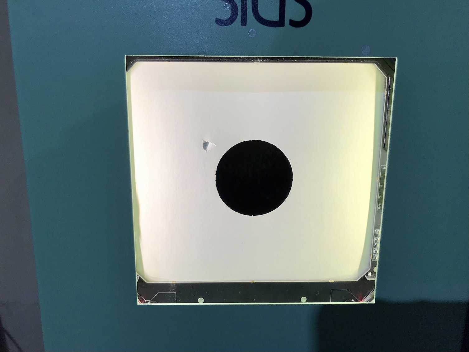

I made a huge mistake and purchased from SIUS USA. 100 of the pistol masks ended up costing us $51.75! The paper tears extremely easily and if someone shoots outside the black, you get a big tear in the paper rather than a clean hole like with Kruger masks. Don't know where I will get replacements, but I won't ever get them from SIUS USA again.

We have not tried the target faces received from SIUS USA yet. If they are tearing easily one wonders if spraying the backs of them with a very light clear coat of polyurethane would help- at least to make them useable in the near term.

We tested one of the target masks from SIUS, with an intentional shot in the white. It definitely tears,…
We will try some clear spray paint to see if that helps make the paper 'crisp.'

The polyurethane helped a bit, but is not worth the trouble. The rubber mask will last quite a while. You can still shoot through it, though.
I would say, stick with the Kruger target masks.

I was just at the JO Air Pistol Championships in Colorado Springs, and noticed that the Megalink masks (ML1038) were larger than the SIUS ones. Cutting them down on all 4 sides and adding 4 paper punches looked like it would then fit the SIUS targets, and the paper quality is good. Unfortunately, when I called the US distributor, they are $85/100 (not including shipping), so probably cheaper to order direct from Germany unless you can't wait for the shipping time.
One suggestion that was made I thought made sense for us since we also use the rifle masks. Since they usually don't get shot to far outside the rifle scoring rings, recycling them as pistol masks might be possible. Need a template to cut the larger hole, but otherwise not too much effort to do this.

From the test done by "m1963" less than a year ago, the current SIUS masks are no where near the quality of paper you get from Kruger. I have a query in to SIUS for current pricing, but unless they've come WAY down in price, we will probably order from Kruger.
