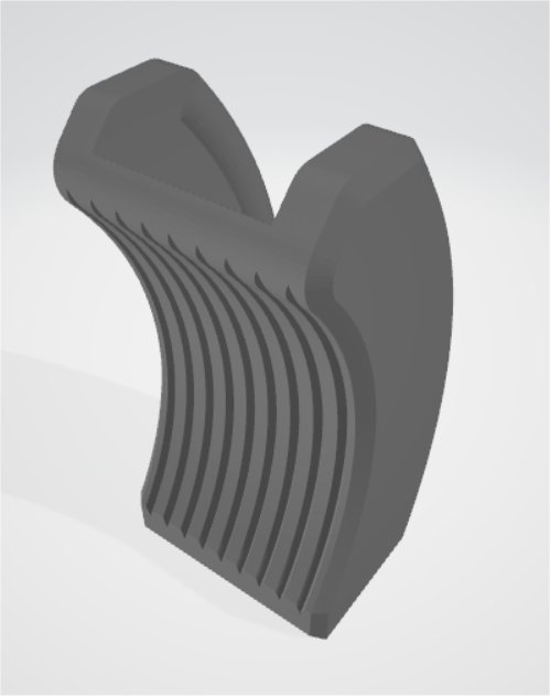

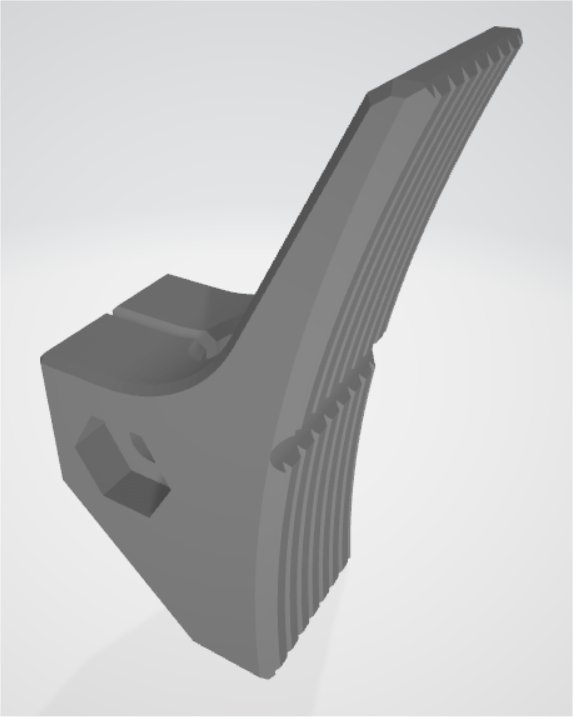

I've had some success 3D printing trigger shoes for various guns. My wife has small hands & very short fingers. I designed & printed a short trigger for her MatchGun MG2:
Short Trigger.jpg (21.85 KiB) Viewed 5078 times
I also made a wide trigger shoe for an AR-7 .22 rifle to make it more comfortable:
AR-7 Trigger Shoe 2.jpg (20.74 KiB) Viewed 5078 times
At some point, I'll need to dig them out & take real pictures..

Gwhite wrote: Fri Jun 04, 2021 8:00 am I've had some success 3D printing trigger shoes for various guns. My wife has small hands & very short fingers. I designed & printed a short trigger for her MatchGun MG2
Hi Gwhite, nice trigger blades. Is there anything shooting-wise you can’t do?
Seriously, I’d be interested to know how you decided where to place the groove in the blade, this being used for determining trigger weight. Obviously, the higher up the blade it is placed, the higher the apparent weight. This means that it would be possible to have an apparent 500g trigger when in reality it is much lighter at the centre of the trigger finger pad.
Posts: 3582
Re: Morini Trigger Blade Options - CM 200 EL
I theory, the groove is supposed to be in the middle. My wife is highly unlikely to ever compete at a level where it matters, so I wasn't super precise about the location.

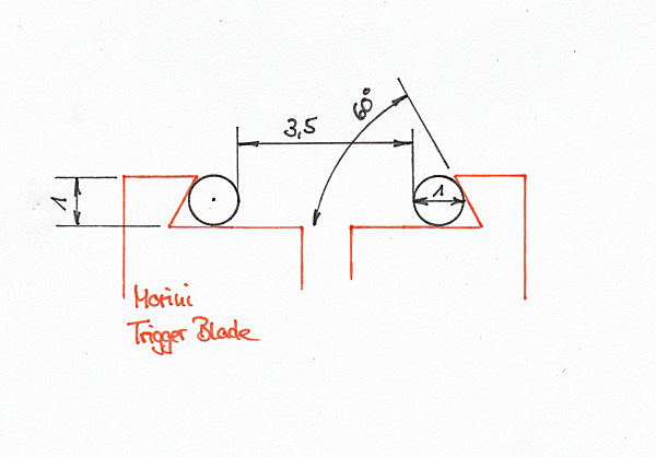

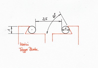

Does anybody who has modeled the Morini trigger or measured it accurately know the dovetail dimensions for the trigger?
Thanks.

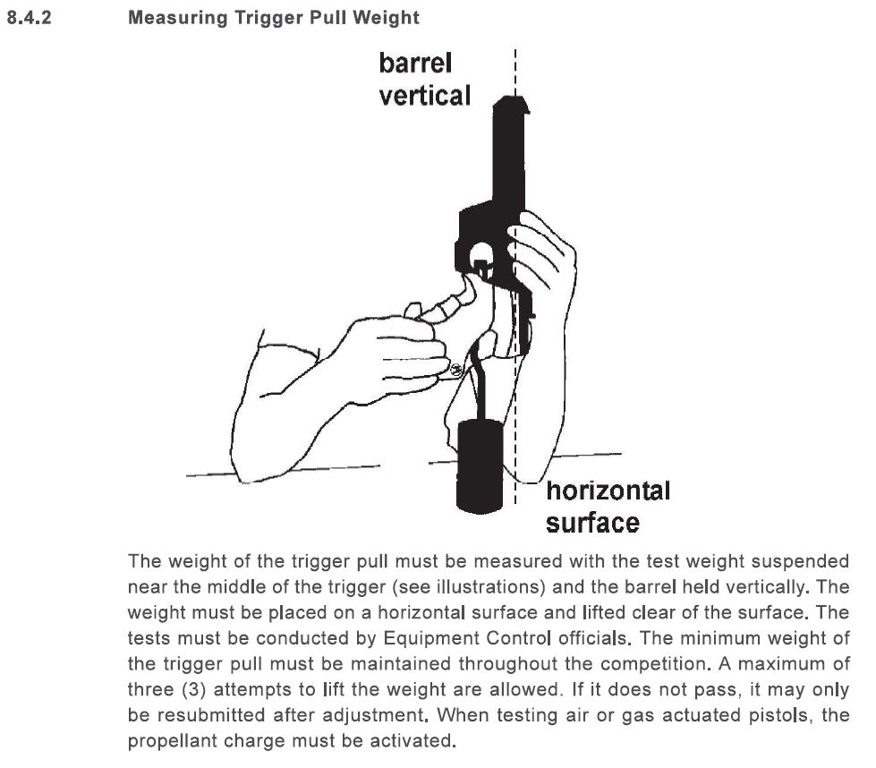

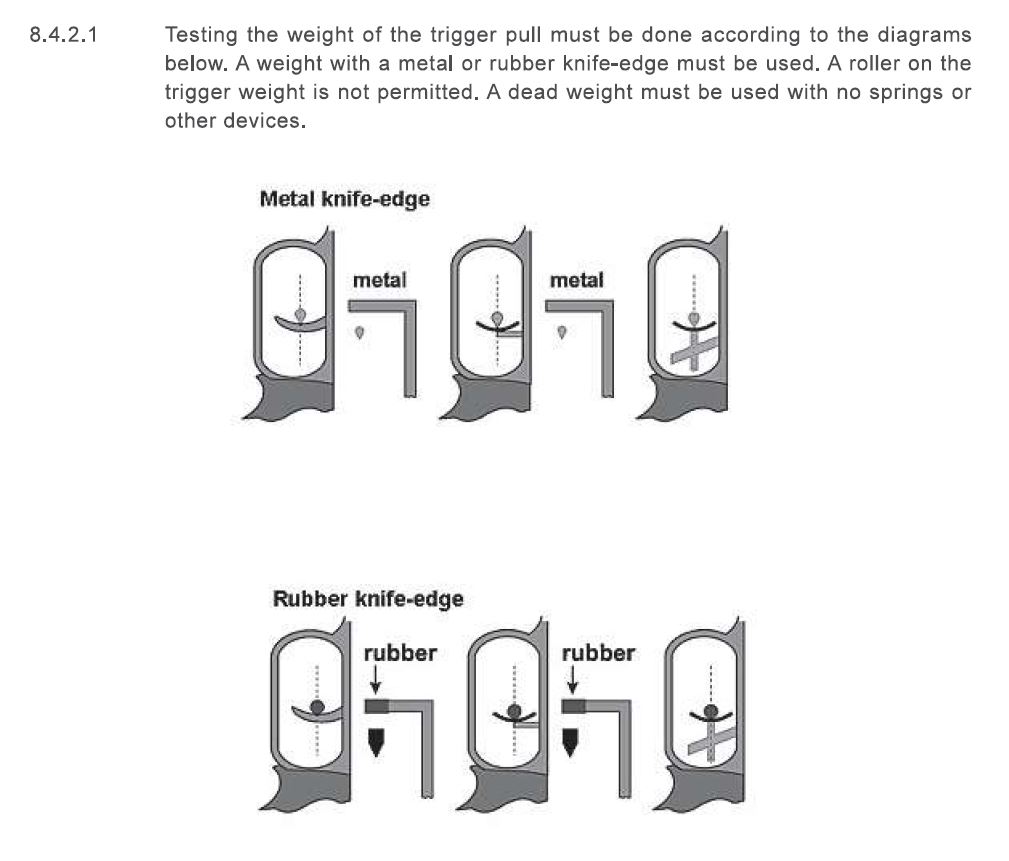

Has anybody failed an equipment check with one of these?
If you check the trigger weight using the notch in the trigger
BUT use it by pulling the trigger at a point below the notch, You have a
below minimum trigger weight. I see pictures at matches and wonder
who will be the first to protest it. It would make an interesting discussion....

aalbert wrote: Tue Jun 22, 2021 10:05 pm Does anybody who has modeled the Morini trigger or measured it accurately know the dovetail dimensions for the trigger?
Thanks.
Yes.

spektr wrote: Wed Jun 23, 2021 12:07 am Has anybody failed an equipment check with one of these?
The trigger weight should be measured near the middle of the trigger.
If there is a notch in any other part of the trigger, that is irrelevant...
Those kinds of protests end very quickly when the person protesting is shown the rule book... ;)
aalbert
Posts: 163
Location: Miami, FL
Post by aalbert »
Thank you for sharing. Cheers.
Observer wrote: Wed Jun 23, 2021 6:35 am
Thanks.
Yes.
