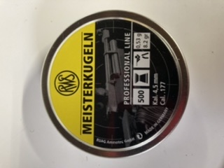

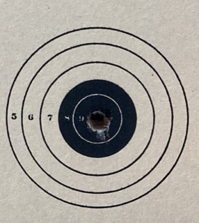

I just bought my first pcp airgun a Hammerli ar20. I know it’s entry level rifle but I have a ton of fun with it. So can you tell me a few things. One should I leave the cylinder charged? In the gun? Do I need to oil anything? Seems like I am getting water as it spits a couple drops on the stock after firing. I must say I am impressed as I was doing some pellet testing and was amazed at this guns ability. I think I found a pellet the gun likes how do I ensure I get pellets that shoot like this? How do you measure them? Here is my best group at 10m this is 10 shots Benchrest.
- 10 shots 10m

Pellets are produced in different sizes, eg. 4.49 and 4.50 and different weights.You select pellets by testing different lots of different sizes and weights
to find what shoots best in your rifle.
