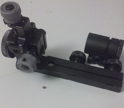

I recently bought an old Anschutz iron sight set for approx 30 euro (+-33USD).
Now was i wondering if it is possible to know which model it is, it hasn't any numbers on it, only the brand name. (see pictures).
Is there anything that i can do to compensate potential wear and tear on the adjusting mechanism, or isn't that really an issue with these things?

Re: Old Anschutz sight
Buck,
The answer is easy, you have a 6702 International rearsight and a standard pre-1987 18mm foresight tunnel. The rearsight was the standard for most Match 54 rifle from at least the early 1960s, up to the late 1980s when it was superceded by the nearly identical 6802. I'd say yours was mae in the 1970s or early '80s. You can see a small hole on the side of the windage turret. This was for a pin that gave a quick reference for your wind zero, and made clickibg easier. The pin wasn't fitted in the '60s, and was dropped in the '80s. Clicks are nominally 1/6 minute. There are screws on the frame, near the elevation turret that can be tightened to reduce slop, but I'd want to check this is actually needed first. The threads may need a good clean to remove dirt and dried oil.
The foresight takes standard M18 elements, metal, perspex, and iris type. The 18 refers to the thread diameter on the thumb screw clamp, the actual inserts are a touch smaller. The base is shaped to fit Anschutz barrels with a dovetail block on the barrel, not the machined-in 11mm dovetail found on current 19xx, 20xx, and 54.30 guns.
At €30 you got a very good bargain.
Tim, thank you very much for your comprehensive answer, much appreciated.
