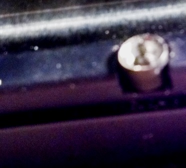

here is what it looks like now.

I can't quite tell by your picture, but if there is room, you can cut a slot across it and use a flat blade screwdriver to remove it. Other things to consider are, was lactite used? If so, then apply heat first. Over torqued might benefit from using some Kroil and let set for a few minutes and then try again. You can also try drilling a hole through the sides of the head and then put a small rod through it and turn. Again, I can't quite see the screw so I'm not sure what would work. There's always the EDM (MDM) :)

Cant tell from the picture if any of the head is sticking up above the surface. I would use a dremel tool and cut a slot in the head and use a screwdriver to remove. If could get a small vice grip on it might also try that.

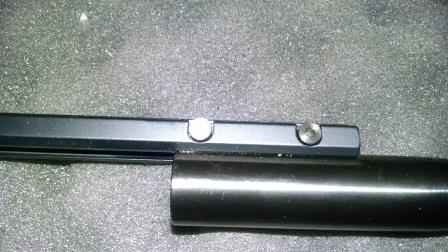

Can you post pics from some other angles?

Here is a different angle of the pic.

That looks like a sight that's attached to a dovetail on the gun. Is that so?
If it is, usually on the other side of the screw there will be a "clamp", to which the screw threads on, in order to squeeze it against the dovetail and hold the sights in place.
If this is what you have, you can simply drill out the head of the screw, until it separates from the shaft. Then you can remove it quite easily. There's no tension on the clamp, so it falls. The shaft that is screwed to the clamp usually unscrews well by hand unless it has been locktited.
Had to do this once on a friend's rifle, as I coun'd get the screw out any other way. On a front sight riser.
Use a handheld screwdriver or a power drill at low speed. Stop once the head of the screw spins loose.
