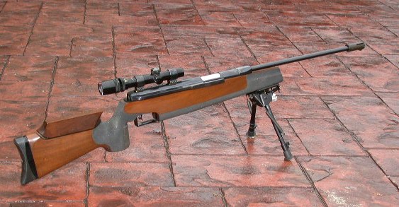

The scope shown was replaced long ago with one that has AO (adjustable objective). Hint: never, ever buy a scope that doesn't have this capability. It really makes a difference if shooting for groups. Who isn't?
Here's what a Feinwerkbau 300S Universal looks like without a shroud. I'm not sure how to upload a picture, but I'll try. Good luck! Packrat1947
[edit] Nothing helps a kid's confidence like shooting some good groups. When Heather used to visit we would retire to the basement for some entertainment. Each time she would shoot a group like this, she would get a silver dollar. Harris bipod, 10 yds, prone. 9X scope. This is just to show you what a kid and decent rifle and trigger can do.[end of edit]
