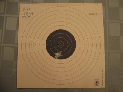

Is the normal aim through the site to low 6 o'clock? Is it normal to be aiming low around 3 ring at 6 o'clock on the target? Just wondering if this is too low? Thanks Ron

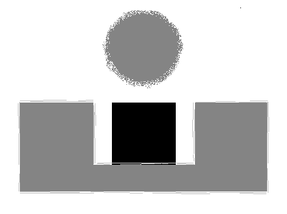

Just to confuse things further, how about the same amount of white showing beneath the bull as is showing on either side of the front sight through the rear notch.

darticus wrote:Is the normal aim through the site to low 6 o'clock? Is it normal to be aiming low around 3 ring at 6 o'clock on the target? Just wondering if this is too low? Thanks Ron
I aim about half way from the bottom of the black to the bottom of the target, so you are not far from that. If you are shooting the groups posted, I would say it works for you. No need to change to what someone else says......

Thanks all just thought maybe I should move to about 5 ring and reset my sight. Ron

Rover wrote:Just to confuse things further, how about the same amount of white showing beneath the bull as is showing on either side of the front sight through the rear notch.
Like this:
This provides a symmetric visual pattern you try to maintain. If you start thinking in terms of what ring you are going to hold at, you will tend to look at the target.
Like this:
I think this is great! I'm going to see if I set reset my sight for this set up. Thanks Ron

Posts: 3559
Re: AIMING FOR 10 METER PISTOL
Exactly! The nice thing about the symmetrical pattern approach is that you aren't specifically trying to align one of the three pieces with another two at a time, you are letting your brain deal with all three as a whole.
Even then, there are bits of the pattern that are more important than others. Sight alignment between front & rear is more critical than the exact distance below the black.

How does your brain decide the 3 points are equal and fire? Thanks Ron

Posts: 3559
darticus wrote:How does your brain decide the 3 points are equal and fire? Thanks Ron
If you think of it as three separate pieces to get right, you've lost the battle. You are trying to establish a visual pattern of the whole correct alignment. The brain & visual system is very good at detecting symmetry. However, it won't know what you are trying to do the first time out. You need to TRAIN your brain to seek and maintain the alignment required to create that symmetrical visual pattern. That means lots of time just staring at the sights, while you work on keeping things aligned. You may also have to play with your sight dimensions (especially the rear notch) to get something that works well for you.
