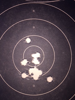

The only problem with finding a load your wad gun likes this much at 50yds,
Nosler 185gr JHP, Remington re-used brass, CCI primer, 4.7gr BullsEye.
4.7gr BE at 50yds.JPG (51.19 KiB) Viewed 4004 times
is that now I know all the 8s, and less, are on me!
Shooting off a rest using my red dot.

I know nothing about .45 calibre but, just out of interest, is this considered to be good grouping?

David Levene wrote:I know nothing about .45 calibre but, just out of interest, is this considered to be good grouping?
Considering it was hand held off a bench, using a red dot scope (no magnification) it is a decent group. I've fired the same load from the Ransom rest, from different accurized pistols, and 2" or less is generally what one can expect. I've seen one-hole groups at 50 yards (under an inch) with this load from the machine rest. A ten shot 3 1/2" group at 50 yards will keep them all in the 10 ring.

I was certainly happy with it. A grain less or more and the group is 50% bigger. And I called the high shot. With my astigmatism, the red dot is more of a figure eight and sometimes I center the wrong part in the black. 1.69" w/o that outlier. :-)

BTW Jabberwo, presciption glasses (fixing your astigmatism) will magically make your red dot round.
When gunsmiths test 45acp barrels for accuracy they can get sub 1" accuracy @ 50yds, but it's rare for the .45acp. A well built 1911 can produce 50 yd sub 1.25" 10 shot groups from a machine rest, but they are pricey. Most bullseye shooters would be ecstatic with a sub 2" gun.

David Levene wrote:
For reference, the NRA conventional pistol target has a 1.695" X-ring and a 3.36" 10-ring (pretty close to one ring larger than the free pistol target, if that makes sense).
So a .45 that shoots a "2-inch group" is an X-ring gun, due to our baffling convention of measuring group size center-to-center while scoring based on inside edge.
Most bullseye shooters can't call their shots within 1 inch at 50 yards, so a 2" gun is fine, but typically High Masters are shooting .45s that are sub-1.5" at 50.

john bickar wrote: Most bullseye shooters can't call their shots within 1 inch at 50 yards, so a 2" gun is fine, but typically High Masters are shooting .45s that are sub-1.5" at 50.
What kind of accuracy should one expect at 25yds from those guns? Half the 50yd group or less than that?

Yeah, free pistol 9-ring=100mm=3.93".

Almost always better than half the size of the 50yard group. Weird things happen to pistol groups between 25 and 50 yards. I don't know anyone that bothers to Random Rest at 25 yards, though; I certainly don't.
And jabberwo, I didn't mean to imply that yours was a bad group. I'd shoot that gun/load combo.

john bickar wrote: Almost always better than half the size of the 50yard group. Weird things happen to pistol groups between 25 and 50 yards. I don't know anyone that bothers to Random Rest at 25 yards, though; I certainly don't.
It gets frustrating that a lot of US magazines and firearms forums will get all excited about 25 yard Ransom Rest groups. You think you're starting to read something informative and it's all participation ribbons.

Most 45's should be able to hold the X ring at 25yards - even if you are shooting lubed rocks!

FYI on the astigmatism, I find a tiny aperture turns the hourglass red dot into a circle again. And, I can see the front sight, too. A lot cheaper than a new prescription.
