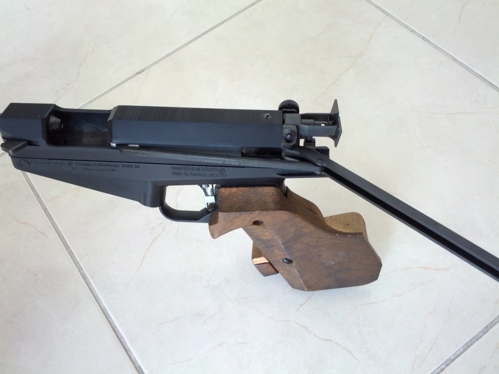

Forgot to ask, did you see the pivot screw on the cocking lever getting loose and preventing the lever from closing and is the slide fixed and not moving at all? Can you post a pic?
Re: Feinwerkbau model 90 electronic
The cocking lever does not goes forwards. It only goes backwards (with force).
I pushed the tab forward and moved the cocking lever backwards and forwards at the same time.
I am sending a picture.

The pic shows that the piston is completely locked backed; has the recoilless mechanism latched itself back up?. If the cocking lever pivot screw did not come loose, then it could be that your pistol has the older seals (white seals turning yellow) that disintegrated and are gumming up the piston and compression chamber. The shiny compression chamber is not made of aluminum, instead it is an alloy that is brittle, so don't force close the pistol.
Your only chance now is to carefully disassemble the upper part of the pistol from the lower part. If your pistol is already loaded with a pellet, remember to get it out first for your safety. Download and examine the exploded diagram from FWB. There is a "tab" that I remember under the upper part that you have to depress for the cocking lever (compression chamber) to close.
When you are able to have the cocking lever closed, don't reassemble the pistol, it needs an overhaul.
