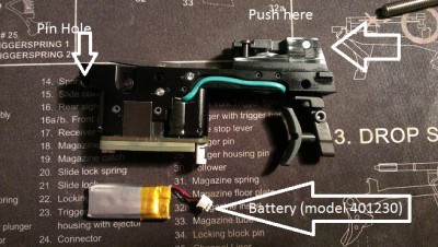

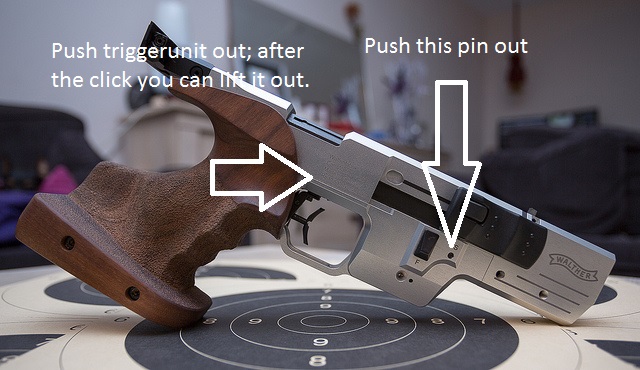

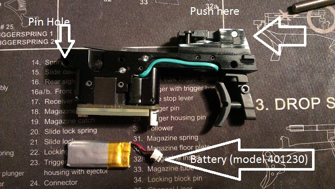

When you use a wrong charger your battery will break and you cant use your Walther SSP-E anymore. Mine broke 2 times and it was about 3 months away from me before i got it back after repair service. It broke down again and i was talking with a technician with Walther and he send me some repair parts so i can repair it myself. Its 30 minutes work if you got the right Equipment. I will explain everything i did how i fixed my weapon.
1. Separate the upper from the lower (the 3 screws on the front of your pistol).
2. Push the pin out (See photo below)
3. When the pin is out you can push the whole trigger unit forward. (You push it forward then you can lift it up.
4. When you have the trigger unit in front of you you see the battery on the bottom. Its is fixed with two sided glueing tape.
5. Disconnect the battery and connect the new one.
6. Put it back together
Thats it. Dont do anything stupid if you don't think you can repair it bring it to a local shop.
I hope i'm helping some people with this.

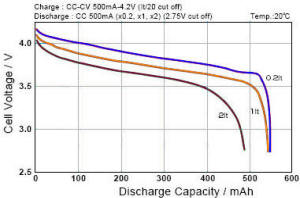

Lithium batteries are great, but they benefit from a little extra care.
For Li-poly battery a fully charged cell would be 4.2V per cell.
The nominal cell voltage is 3.7 v, and a fully discharged cell for long life should
not go below about 3.0v (better lower limit is 3.2v or 20% remaining).
The critical discharge voltage is 2.5v, at this level the cell is damaged and
cannot/should not be used.
The more serious issue is overcharging. If one cell gets seriously over charged
getting well above the desired 4.2V top charge. This can result in pack failure
or can cause the over charged cell to "vent with flame". ie FIRE
I don't know the Walther circuit, but a properly designed Li-Po battery setup should
have both a over voltage and under voltage protection circuit as well as a automatic
charger circuit for Li-Po.

This time if a cell falls below 3.2v charge it, if it falls below 2.5v scrap it, DO NOT attempt to charge/overcharge a LiPo or you risk a FIRE.CamelNL wrote:I tested the batteries with a multimeter and the broken one only gave 1.2 volt. After 30 minutes of charge he didnt fill up. :P.

I would like to add to CamelNL’s post regarding a battery change in the Walther SSP E.
Before trying to press out the pin holding the trigger assembly in place first loosen the grub screw from above that locks the pin securely otherwise damage will occur.
Once loosened the pin requires almost no pressure and the job is easily performed.

The battery 401230 is a lithium polymer or lithium ion battery which is 4mm x 12mm x 30mm in form factor size.
It is a single cell 3.7v battery with a JST plug. Cells vary from 80-120mah capacity.
This cell is available in two forms, with or without the built -in PCB charger board.
It looks in the photo like the Walther battery has a PCB mounted on the cell end and standard JST-SH (1mm pin) plug.
The PCB board has a under and over voltage cut-out to allow charging from a 5v source such as a USB port or charger (provided the USB output is sufficient).
Check that your charger has sufficient output, the default output of most is only about 100ma (max. output is 500mah).
The cell without the PCB will require LI-Po charge for charging a 1S cell at 0.5 to 1C.
These cells are available on the internet for $6-$15.
You may need to purchase the plug separately.

Re: Fixing dead battery Walther SSP-E
Genuine Walther part supplied for the equivalent of $30 USD. Plug & Play.
