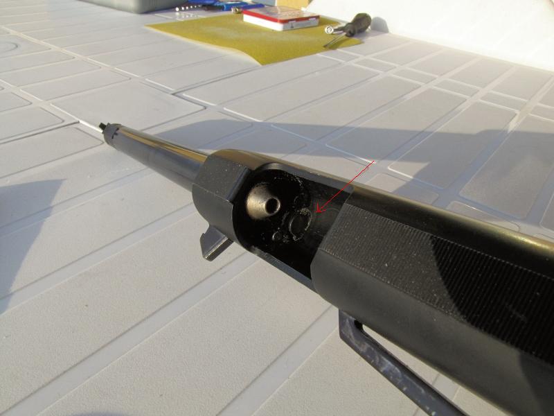

A broken detent lever could also be the culprit. This is the part of the trigger mechanism which blocks trigger release until the breach is fully closed. There is a tab of metal directly under the rear of the barrel which is pushed forward by the buffer on the lower portion of the breach face when closed. If this tab has broken off or the buffer is missing then this part of the mechanism is not being disabled. If this is the case you will need to remove the lower 'frame' portion of the pistol to manually activate the lever and operate the trigger. The above link to Cones' breakdown is very good for helping you disassemble the pistol however I don't think it covers disassembly of the trigger group (could be wrong I haven't looked at it for a while). Basically I disassemble the trigger group I work from the front to the rear. Just make sure you take lots of pictures if you are unsure what goes where, lay parts out in a clear order and don't mix up the springs. For replacement parts I've always dealt directly with FWB and have always had very good and prompt service.

Dr Mandible wrote:A broken detent lever could also be the culprit. This is the part of the trigger mechanism which blocks trigger release until the breach is fully closed. There is a tab of metal directly under the rear of the barrel which is pushed forward by the buffer on the lower portion of the breach face when closed. If this tab has broken off or the buffer is missing then this part of the mechanism is not being disabled. If this is the case you will need to remove the lower 'frame' portion of the pistol to manually activate the lever and operate the trigger. The above link to Cones' breakdown is very good for helping you disassemble the pistol however I don't think it covers disassembly of the trigger group (could be wrong I haven't looked at it for a while). Basically I disassemble the trigger group I work from the front to the rear. Just make sure you take lots of pictures if you are unsure what goes where, lay parts out in a clear order and don't mix up the springs. For replacement parts I've always dealt directly with FWB and have always had very good and prompt service.
DING, DING, DING, DING!!! We have a winner! This morning I picked up the pistol from where I'd left it propped to allow the lubricant to set overnight and started examining it in good light, looking for how everything works. As I looked into the loading port I could see a gap under the barrel (as described by Dr Mandible) and could see how there SHOULD have been a tab sticking up to allow the detent to be pushed forward to allow the pistol to fire. That tab was (is) missing and explains the stray bit of metal that fell out the other day when we opened it up for the first time in ??? years. So now I'll have my friend place an order with FWB for part number 1600.143.1 - Sperrscheieber/Detent lever as well as the seals. Thank you Dr Mandible for confirming my analysis. It was good to see your post when I logged in to relate what has turned up (so far).

Yup, the description and part numbers you mentioned are correct, FWB grease is 1750.010.3 Spezial Gleitfett 4g. They have all the parts you require, and if they don't have it, I am pretty sure they can make it for you. The part that is giving you problems is the tab that broke off that allows the sear to disengage when the breech is closed.
- FWB 65.jpg (51.89 KiB) Viewed 3791 times
