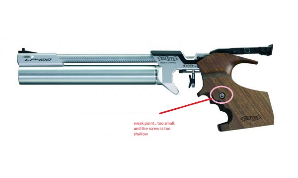

1. Give lubricating oil on the metal parts the trigger. I watched my trigger belongs lp400 never opened due to rust and oil. It should match the weapon is already expensive maintenance free.
2. not too often turning the bolt next to the grip. Can quickly wear out and the gun becomes solid in place (except Walther had already improved by replacing the larger bolt and screw deeper grooves)
- LP400 Carbon left-1000x600.jpg (31.7 KiB) Viewed 7344 times
