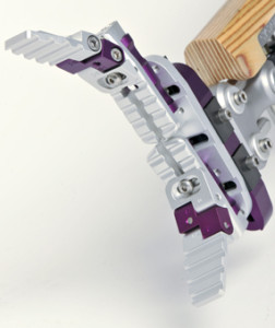

Hello all,
Returning to smallbore prone after quite a few years off. I'm still shooting in the low 590s (592-594) and think that I could probably get a wee improvement by changing out my free rifle buttplate for a more modern design.
Any suggestions for a buttplate (for prone only) that will bolt on to the Supermatch 54 (vintage 1972)? I've included a photo of what mine looks like (not the actual one but identical).
I just don't feel the current buttplate locates as consistently in my shoulder as I would like and this seems like a worthwhile change.
regards,
Stefan
Seattle, WA
regards,
Stefan
Seattle, WA
- buttplate2.jpg (23.25 KiB) Viewed 4585 times
The current stock on my rifle started with that same vintage buttplate, and I had the same issue. The original buttplate had all the pressure on one spot of my shoulder which was SUPER uncomfortable. I swapped it out for an Anschutz 4765 buttplate with the 8510 (Precise) guideplate. It took a little creative engineering to mount it, but a couple screws with washers later I was in business. I'll try to get some photos up tomorrow.
I have found the older Anschutz butt (as pictured) doesn't adjust high enough for me, so like Mtncwru all the pressure is at one point at the top.
The current Anschutz 4765 should bolt straight onto your carrier (the black steel part), so long as you have the vertical mounting rod. I did this recently with an SKP prone plate, which uses the same vertical mounting rod.
Alternatives to the 4765 would be the older Anschutz 4760, which was used in the 1980s and '90s on the 1813 and 1913. The System Gemini is very good (www.rifle-maker.com), I've used one for the last ten years. It can be bolted onto the carrier, or directly into the base using the rods supplied. I imagine the MEC and TEC-HRO butts could be fitted as well. If you are only shooting prone, and don't want a hook, there is the SKP from New Zealand.
I had a Gemini butt on both an 1813 and a 1407, and don't recall any need for fitting. It should be the same for a '72 Supermatch. With a Supermatch, the Gemini can use the existing base. Pull out the existing buttplate and extension rods. Then screw the supplied rods onto the Gemini, and slot these into the aluminium baseplate on the rifle. Tighten up the locking nut at the top (or bottom for newer rifles), and it's done.
With the 1407 it screwed straight on, using the existing bushings, once the plastic factory butt had been removed.

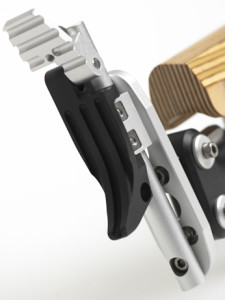

Aktiv buttplate
I take the recommendations are stronger for the Aktiv buttplate than for the standard buttplate?
- Aktiv buttplate.jpg (38.15 KiB) Viewed 4417 times
Re: Aktiv buttplate
Yes because you can adjust it more to get a better fit. Just be mindful of the rules should you shoot ISSF competitions. In that case the upper curve of the buttplate can only extend rearwards 25mm.artandscience wrote:I take the recommendations are stronger for the Aktiv buttplate than for the standard buttplate?
Rob.
The standard buttplate was developed to meet UIT rules for 10m air rifle and 50m standard rifle, as an improvement on a basic rubber buttplate. You can certainly use it for 50m prone; it's used with Gemini fullbore/palma rifles as GB-NRA rules do not allow hook butts for this discipline, but it won't give you the same fit as the Free rifle butt, as it is much smaller and lacks the facility to offset the butt laterally or cant it.
Rob is quite right that you have to watch the curvature of the heel (top) plate. Gemini free butts now come as standard with a double joint, what they call a cantilever. The heel plate generally won't meet the ISSF's 25mm depth rule with the cantilever inserted. It can be removed very quickly with a 4mm allen key.

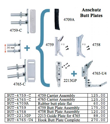

Aktiv vs. standard buttplate vs. Anschutz 4765-U4
I use the standard buttplate on my fullbore rifle (.308). It does indeed flatten during recoil. However, the set screw only allows it to flatten so much and so it still works (when adjusted properly).
I think I'll sadly go with the Anschutz 4765-U4 as pricing out the Aktiv with Robert came to over $500 with the current exchange rate.
However, I'm not quite sure that it will be a savings unless I can use my current 1413 carrier with the 2213 guide plate and the 4765-U4. Anyone done this?
If I can, it will save me about $150.. I think at least one person said that the 4765 assembly doesn't give up anything to the Aktiv buttplate?
Thanks,
Stefan
Thanks,
Stefan
Stefan,
you should not need to replace the existing extension rods to fit the 4765 butt. If the 2213 guide plate does not fit directly, you could remove the vertical rod (onto which the 4765 butt clamps), and fit the rod directly onto the 1413 extension.
As for 4765 v Gemini, I think the Gemini is better, and offers a closer fit, especially at the top of the shoulder, although with the ISSF 25mm rule, the difference is lessened. This is not to say the 4765 is bad; I would much rather have the 4765 than the original 1413 butt.
