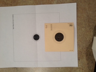

scatt mx-02
I just got this expensive piece of equipment. I use it mostly indoors for air rifle and 3 P training at a distance of 10 meters. I have to say it is wonderful for air rifle training, you just point, it calibrates and you are done. No frame, no cables for the most part and works wonderful.
The issue comes when you go to the smallbore 3P at the same distance (10 meters, simulating 50), I do not get the sensor to show me the cross hair and register the calibration shot. It seems to pick it up intermittently and does not allow the calibration.
I am just surprised that it does not have any problem for the 10 meters air rifle, air pistol and even for 50 meters pistol (i have tested all those). but it just does not work for smallbore rifle and big bore (300 meters simulated distance).
My target seems to be well lit, since the problem is only for the 50/300 meters rifle, so I am not sure what is going on.
From the review mentioned in this thread it seems like there is a parallax error going on, however I cannot explain why it works for some distances and not the others.
Any help will be appreciated. I did send a message to scatt.com, but so far I have had no answer.

scatt mx-02
Thanks. Yes, I use the 10 meters air rifle target as I used to do with my previous scatt solution.bluetentacle wrote:Are you using the correct target, scaled to the correct distance? I had this issue when the size of the target dot was off.

Re: scatt mx-02
Uh, you need to use the scatt software to print out a 50m target scaled down to 10m. Unlike IR SCATT, MX-02 is sensitive to the apparent size of the bullseye. The 10m bullseye is angularly bigger than the 50m bullseye.guidolastra wrote:Thanks. Yes, I use the 10 meters air rifle target as I used to do with my previous scatt solution.bluetentacle wrote:Are you using the correct target, scaled to the correct distance? I had this issue when the size of the target dot was off.

Re: scatt mx-02
This is correct you must print a target using the SCATT software. Obviously on good white paper so the contrast from black to white is the best it can be.bluetentacle wrote:Uh, you need to use the scatt software to print out a 50m target scaled down to 10m. Unlike IR SCATT, MX-02 is sensitive to the apparent size of the bullseye. The 10m bullseye is angularly bigger than the 50m bullseye.guidolastra wrote:Thanks. Yes, I use the 10 meters air rifle target as I used to do with my previous scatt solution.bluetentacle wrote:Are you using the correct target, scaled to the correct distance? I had this issue when the size of the target dot was off.

Re: scatt mx-02
I did try to adjust the brass screws last night and did not really work. I will certainly try printing new targets today as recommended by you and will let you know.HWN1011 wrote:This is correct you must print a target using the SCATT software. Obviously on good white paper so the contrast from black to white is the best it can be.bluetentacle wrote:Uh, you need to use the scatt software to print out a 50m target scaled down to 10m. Unlike IR SCATT, MX-02 is sensitive to the apparent size of the bullseye. The 10m bullseye is angularly bigger than the 50m bullseye.guidolastra wrote:Thanks. Yes, I use the 10 meters air rifle target as I used to do with my previous scatt solution.bluetentacle wrote:Are you using the correct target, scaled to the correct distance? I had this issue when the size of the target dot was off.

Re: scatt mx-02
It actually worked. I did print a scaled 50 meters smallbore rifle on a white background. I also noticed the target is way smaller than a 10 meters air rifle target. Image attached.guidolastra wrote:HWN1011 wrote:This is correct you must print a target using the SCATT software. Obviously on good white paper so the contrast from black to white is the best it can be.bluetentacle wrote:Uh, you need to use the scatt software to print out a 50m target scaled down to 10m. Unlike IR SCATT, MX-02 is sensitive to the apparent size of the bullseye. The 10m bullseye is angularly bigger than the 50m bullseye.guidolastra wrote:Thanks. Yes, I use the 10 meters air rifle target as I used to do with my previous scatt solution.bluetentacle wrote:Are you using the correct target, scaled to the correct distance? I had this issue when the size of the target dot was off.
thanks a lot !
