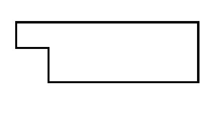

Dry Firing a Marvel conversion
I insert a yellow #4 (I think) dry wall anchor in the chamber and then as I close the action I also place a piece of a rubber band shaped like this. ( hopefully, see attached jpg) I bought a pack large rubber bands at Staples. Get 2-3 dry Fire protectors out of each. Using the rubber band keeps the dry wall anchor good for hundreds of dry fires. Replace the rubber piece when it gets too nasty with carbon etc.
Scott,
Vermont
Scott,
Vermont
- Dry Fire Rubber Band.JPG (12.2 KiB) Viewed 3944 times
