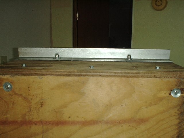

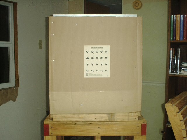

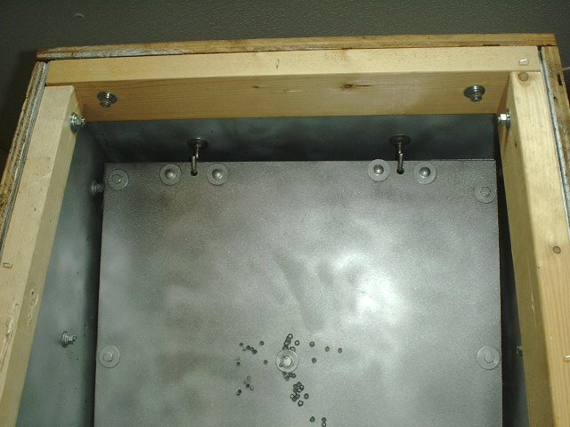

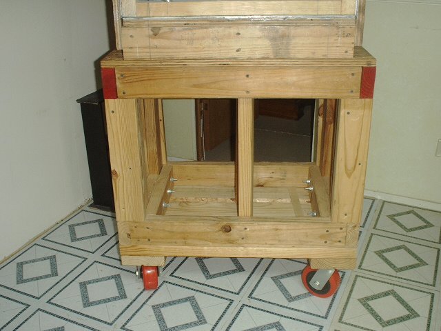

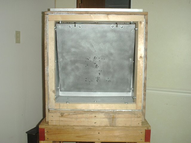

Here is the pellet trap that i built for my use indoors at 10 meters. The trap is approx. 24" tall by 24" wide and 16" deep. The plywood on the outside is 3/4 inch plywood. I used 1/8 inch thick steel plate for the top, both sides, bottom and the back.
I used a mud flap to go between the steel plate and the plywood in the back. The mud flap takes all of the ring out when the pellet strikes the plate. All 5 steel plates are bolted to the plywood.
I then took another piece of 1/8" thick steel plate, a mud flap and a piece of 1/2" plywood and bolted the 3 pieces together. This hangs from two hooks about halfway back from the front. The two hooks that hold up the angled striking plate are bolted to the piece of angle iron that is across the top of the trap. The bottom was wedged to the back. Now this striking plate is at a 45 degree. When the pellets strike the angled plate, you just hear a dead thud. The pellets just fall to the bottom.
I bolted 4 wooden strips to line the inside front edge of the trap. Now I am able to just staple a big piece of cardboard to the front of the trap. This makes the trap completely enclosed. The pellets stay inside the trap and no bounce backs. I just staple my paper practice targets to the cardboard.
I guess the trap weighs somewhere between 125 and 150 lbs. I takes two men to pick it up. the trap sets on a rolling stand. I can roll it to where ever I want it.
pellet trap 001.jpg (51.75 KiB) Viewed 6024 times
pellet trap 005.jpg (46.77 KiB) Viewed 6024 times
pellet trap 003.jpg (54.11 KiB) Viewed 6024 times

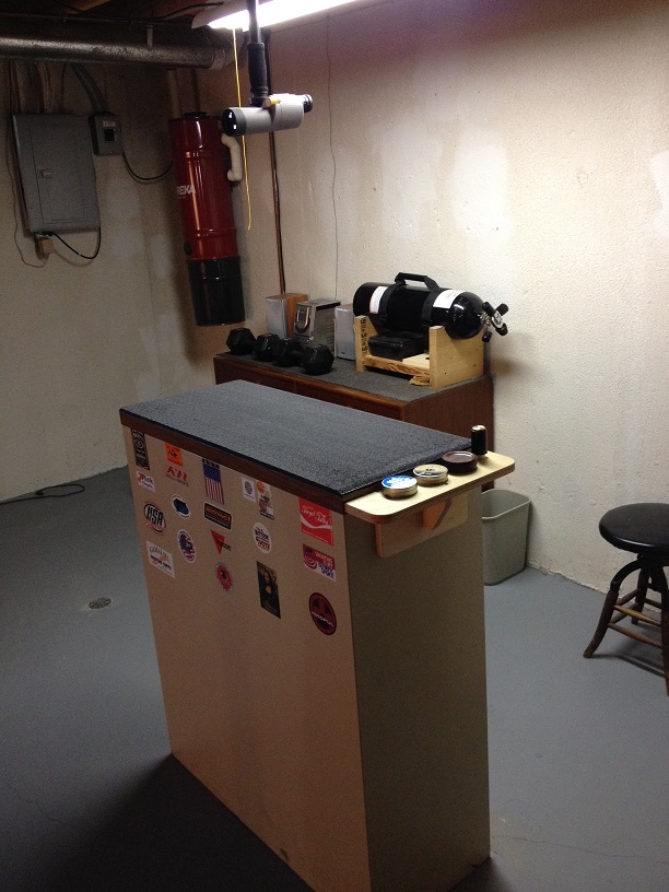

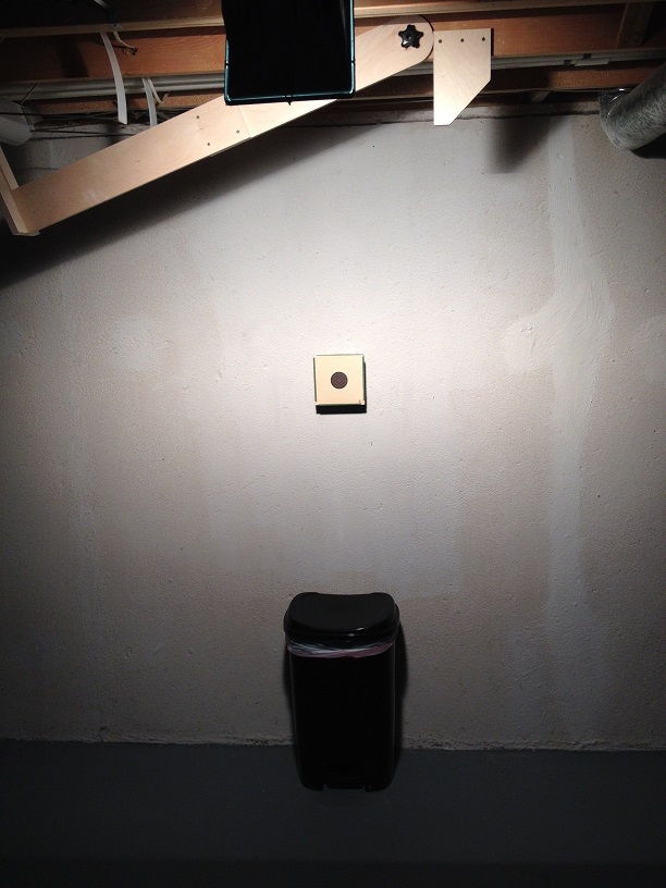

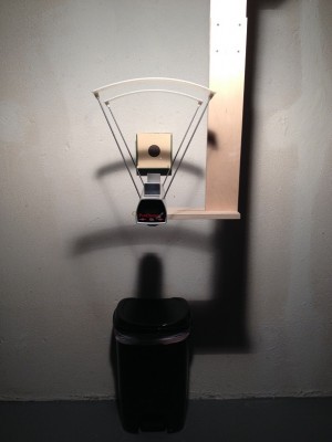

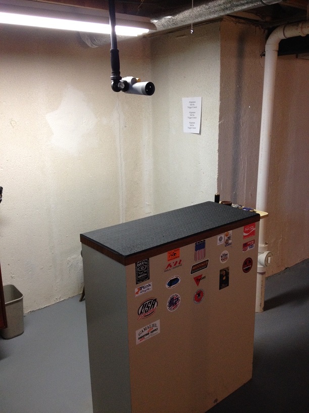

I also have an indoor range. It is ISSF compliant. Firing line has a bench with a rubber mat and a 20x spotting scope suspended from the ceiling, I only move my head a couple of inches to use. The target is in a Gehmann trap. Targets are illuminated by a 500w quartz lamp. There is also a chronograph that swings down from the ceiling.
Gort

Gort,
Very nice setup! I like your ceiling mounted chrony and spotting scope!
