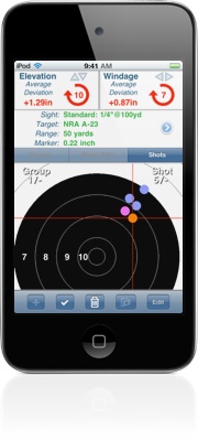

The app isn't quite as straightforward as a diary. Based on the click settings, range and target that you have entered, it is actually calculating the click settings that you need to apply. So it's taking care of the things that conradin is remembering. So would that classify it as a training aid? I don't know.
From a rules perspective, it would certainly be possible to disable the possibility of communication, simply by putting a device into "airplane mode". However, I would think that would make competition more difficult to police than just a blanket restriction on electronic devices.
To make it a little easier to understand the context, I have attached a screen shot.
(Thanks Gerard and Ricardo for the settings.)
