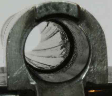

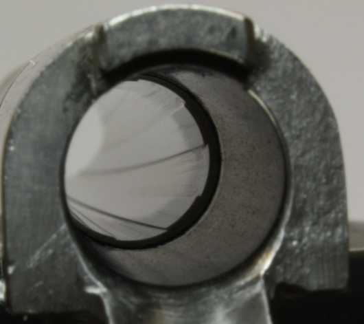

I have been trying to shoot a Model 52 on a budget and reloading is not an option in my apartment. I've tried a couple of remanufactured loads. I have no prior experience by which to judge, but I think that this last batch is leading excessively. I cleaned the barrel until it was absolutely clean and mirror bright and used it yesterday for just 30 rounds. Attached are the before and after pix. The second shot was taken after I pushed a brush and patch though it to knock off the loose debris, so I assume most of what's left is lead. Is it excessive? Also, should I be concerned about the crud buildup along the front of the chamber?
Roger
Roger
- IMG_4457_mod.JPG (23.42 KiB) Viewed 7373 times
- IMG_4427.JPG (24.89 KiB) Viewed 7373 times
Looks like lead to me. The charge is probably too heavy. Switch ammo manufacturers. Zero ammo is very good. You can find reman .38 SPL hbwc ammo on their website: http://www.rozedist.com/mm5/merchant.mv ... e=ZBA-38SP

Misny:
Thanks for the reply. Yeah, it's lead. It took me over a half hour to get it out with a bore brush and lead removing cloth. The stuff in the chamber was the most resistant, and that worries me a bit.

Just take a tired bore brush and wrap it with a few strands of copper "Chore Boy" scouring pad. A few strokes will rip that stuff right out.

I have a S&W model 52-1 and I don't get lead in any great degree. It is possible that the reman ammo you are using is too "hot". With Zero ammo you shouldn't have any huge leading problems. I sent you the wrong link for the ammo. You would do best to stick with the 148 gr. HBWC bullet for your. I use them to reload my own ammo for my model 52-1.RandomShotz wrote:Misny:

That looks like bullets that are undersized to make that amount of leading in 30 shots. I would slug the throat end of that barrel. Measure the groove size and shoot bullets that are .001 over groove size. The worst leading is caused when propellant gas excapes around the sides of the bullet. The loss of this gas reduces chamber pressure and does not allow the shell casing to expand to fill the chamber. Lead can then travel and get between the case mouth and the chamber wall, which is what I am seeing here. Hope this helps

j o danielsson: I have not pulled a bullet to check but they are supposed to be HBWC.
I have ordered a reloading setup and expect it to be here next week. I will use one of the bullets to slug the barrel just to make sure that it is in spec, but I see no reason why it should not be. But I suspect that levergun is right about the heavy deposit at the mouth of the chamber being difficult to explain unless something was coming back and getting between the case and the chamber wall.
Something just occurred to me: I noticed that the .38 special brass also comes in a +P variety. Are they stouter than ordinary .38 spl brass? Since the re-man loads were from a range, could a few +P cases have failed to expand with the "moderate" loads intended for the 52?

P+ Brass
P+ brass is a lot thicker. With a "normal" cast bullet and P+ brass you might not be able to chamber a round unless the chamber is oversize or the bullet is undersize. I couldn't chamber any P+ brass in my Colt 38. I used a commercial HBWC with VV N310. N310 is possibly the fastest powder on the market and should obdurate the skirt of the HBWC to seal the barrel and also push the brass to seal the chamber. Sometimes it is necessary to not shoot a bare minimum of powder in an auto 38. They are picky about the loads they digest. Hope this helps.

Okay, so that probably explains a lot of my problem. If a+P case did not expand and some blowback got into the chamber, then that would explain why I had a failure to extract. I don't know what I'm going to do with the last 100 rounds of this stuff, but I'm not comfortable shooting it in a 52.
