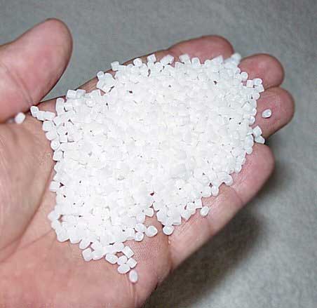

GCSInc
Posts: 246
A better Mouse Trap!
Post by GCSInc »
These work better than Crumb Rubber, and Steel is the worst offender of creating "dust".
Here are just a few ideas to stir the conversation...
Roy
