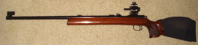

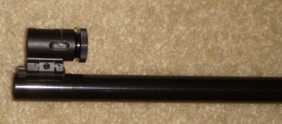

One of the small bore guys trying to get me into the sports has a used Anschutz front sight 9759 that will work on my front sight base and it comes with a set of Slimline clear inserts & can pick it up for a reasonable price.

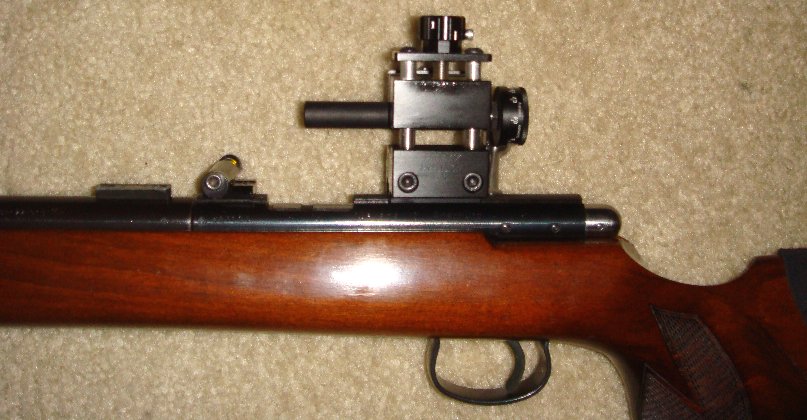

Just for grins I put my Palma rear sight on it - Phoenix Precision not a great fit. May be OK for some ammo test this afternoon.

Try your Palma sight by all means. There is nothing to say you can't use a fullbore sight, in fact many people do. Obviously it would be better to have a dedicated smallbore sight, just to save time and ammo on the sighter.
The Gehmann and Centra sights will have much finer clicks than your Palma sight. The nominal value is 1/12 minute. Some shooters prefer coarser clicks (1/4 or 1/6), it seems more so in the US as the 10-ring is rather larger than on International targets. You may also find that these sights block off more of your view down range thasn you are accustomed to.

It looks from the photos that the rear sight is way too high in relation to the front sight. try winding it down to minimum elevation and make sure you have a sufficiently tall target sheet/backer and a decent backstop, or your shots will sail over the range wall and end up in the next county!

timinder wrote:It looks from the photos that the rear sight is way too high in relation to the front sight. try winding it down to minimum elevation and make sure you have a sufficiently tall target sheet/backer and a decent backstop, or your shots will sail over the range wall and end up in the next county!
timinder
You are correct and I have a rear sight set that I've purchased from a member of this forum that should be here in a few days and should resolve the height issue.
I did basic bore sight through barrel and noted I could not get the rear Plama sight down far enough for front sight line up.
