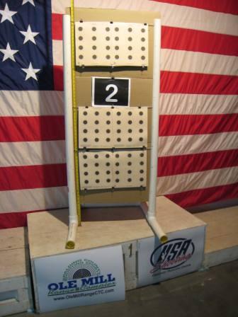

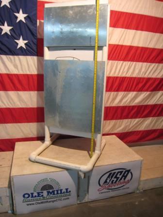

Pellet Backstop / Target Holder
Let us know what You think of these.

- Copy of IMG_1898.JPG (27.74 KiB) Viewed 4897 times
- Copy of IMG_1892.JPG (26.44 KiB) Viewed 4897 times

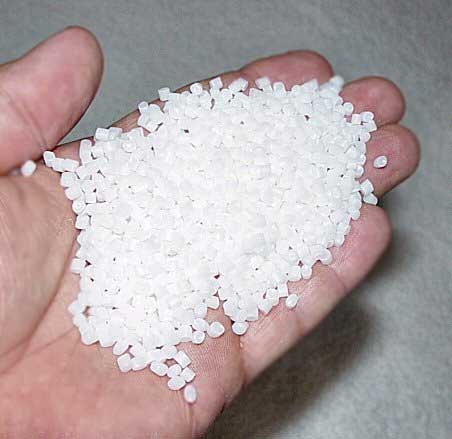

Beads or Resin
http://www.youtube.com/watch?v=bit-D1NnfjI (only about the first 10 seconds talks about and shows the Beads)
These are simply "Injection Mold Beads or Resin" the raw materials in all Injection Mold processes. These Beads or Resin come in every color you can imagine. We like "white" for kneeling rolls (no dust), but any color is fine for the .22 Bullet traps. I've tried the ground up rubber and find it too course. The ground rubber doesn't compact as tightly. I think part of the secret of this type of "trap" is the small size of the beads and that allows for tight compression of the Beads and therefore it stops the bullet as the Beads compact. Sort of like Kevlar is better at stopping bullets than knives or icepicks.
Our research shows that a .22 bullet (approx 40 grn) at less than 1100 fps will only penetrate about 1.25" to 1.50" into the beads in our traps. The bullet will "mushroom" about 30%, and over time, as you continue to shoot and "vibrate" the Beads, they work their way towards the bottom of the trap.
We've been told that the Beads cost about 50 cents per pound. That may be a bit dated, but I wouldn't think it's too far off. The Beads usually come in what's called a "Gaylord" Box which will weigh about 1000 - 1100 lbs full.
The best place to find the Beads is to contact all your "Injection Mold" factories in your area and ask for their "Floor Sweepings" or end-of-run left overs. When these companies change products, or colors, there's usually a little left over. It may be all you need and they would likely be happy to donate it especially if you give them a Tax Letter for their donation to your organization.
