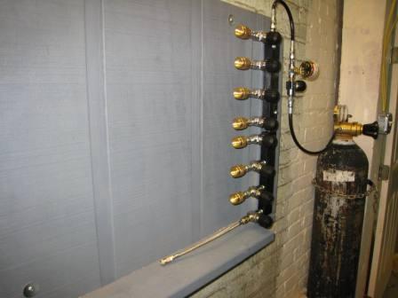

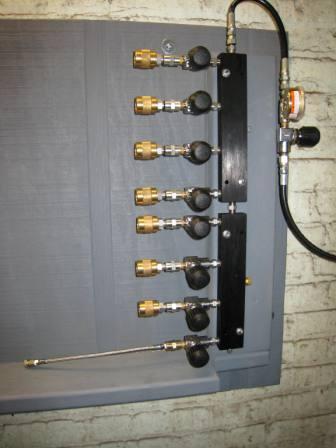

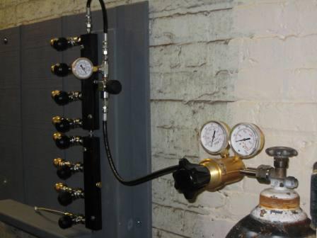

OMRC Nitrogen System
- OMRC Nitrogen System.jpg (22.3 KiB) Viewed 5987 times
- OMRC Nitrogen System 2.jpg (23.54 KiB) Viewed 5987 times
- OMRC Nitrogen System 3.jpg (20.74 KiB) Viewed 5987 times

In enclosed environments You're correct. In an old (nearly 100,000 sq ft) Warehouse that was built in 1880, not so much... You could release the Nitrogen full open and it would never displace enough Air to cause the problems you're concerned with. Nitrogen is lighter than air and Our range is more that 26,000 sq feet x 11 foot ceilings. The Tank is Chained to the Wall, and the valve is closed when not actually filling cylinders.
Depends, pure Nitrogen is marginally lighter than 'air', but then cold nitrogen released into warm air can be more dense. And I haven't noticed a layer of pure oxygen forming around my feet due to the density difference.
It was a general warning to those membersof the forum who don't use your range.
